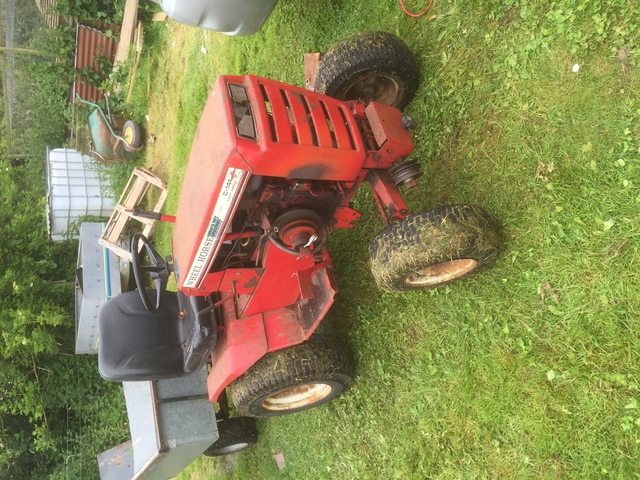

Ryan Revs 1 #1 Posted May 27, 2016 Hi all. I am new here but I have just bought a c141 for restoration. It is in reasonable condition. It is the 8 speed manual. Does anybody know how I can find out which belt goes from the pto pulley to the mower deck? Thanks Share this post Link to post Share on other sites

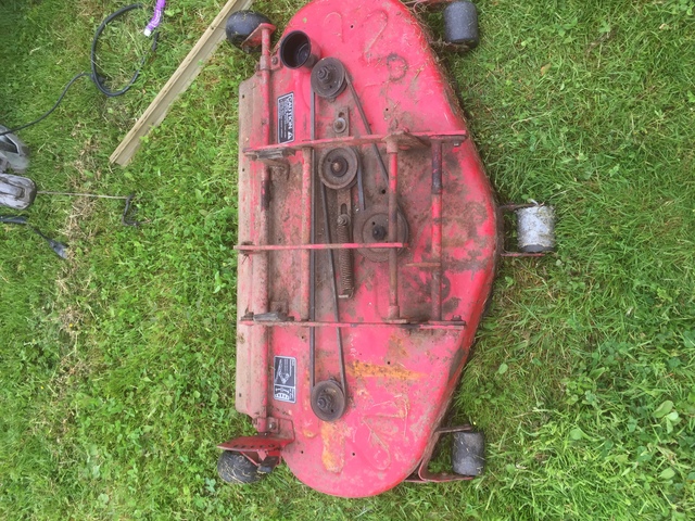

Ryan Revs 1 #8 Posted May 28, 2016 Hi. I can't find a serial number on the deck. It is 3 blades, rear discharge and 42" from blade tip to blade tip. 1 Share this post Link to post Share on other sites
Ryan Revs 1 #9 Posted May 28, 2016 Is this the one ? Thanks everbody for your help http://www.beltingonline.com/wheelhorse-108834-deck-belt-542mr-42-rear-discharge-1247 Share this post Link to post Share on other sites
gwest_ca-(File Mod) 12,533 #10 Posted May 28, 2016 108834 is correct or Garry Share this post Link to post Share on other sites
