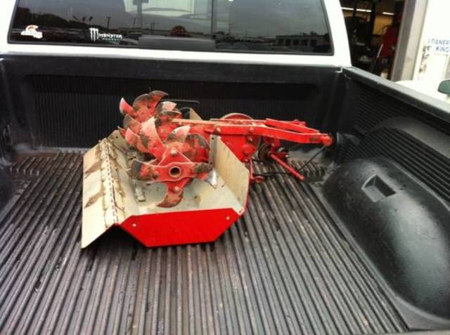

goblbustr 9 #1 Posted May 27, 2016 Can one of you gurus tell by this photo if this will fit my 75 c160. Thanks Share this post Link to post Share on other sites
clueless 3,440 #2 Posted May 27, 2016 Should be no problem, looks like you need the rear hitch. Chris in Florida. Share this post Link to post Share on other sites
goblbustr 9 #3 Posted May 27, 2016 Great, thanks for the reply. By hitch do you mean the bracket that bolts onto the axle? Share this post Link to post Share on other sites
JAinVA 4,638 #4 Posted May 27, 2016 (edited) You will need the hitch that bolts/clamps to the rear axle.You will also need the rockshaft,lift cable and trunion.The lift assist spring is of great help. Luck,JAinVA JimAnderson Gloucester,Va Edited May 27, 2016 by JAinVA Share this post Link to post Share on other sites
gwest_ca-(File Mod) 12,511 #5 Posted May 27, 2016 Here is the manual for the tiller sold in 1975 for your tractor. The basic design never changed so you should be able to make it work. Garry Share this post Link to post Share on other sites
