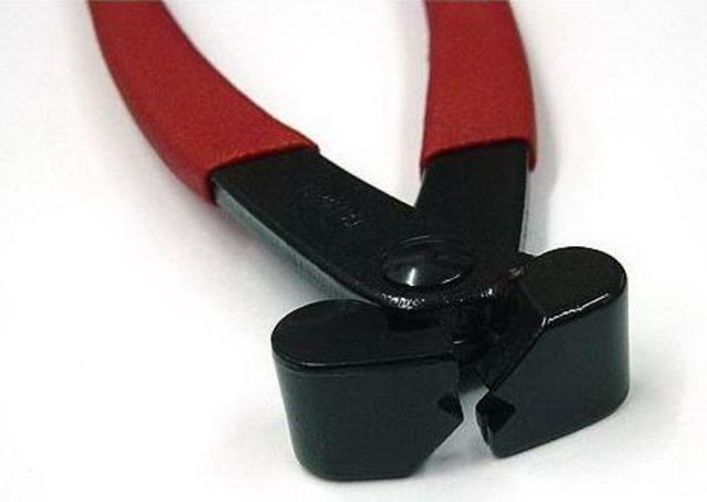

CasualObserver 3,416 #8 Posted July 14, 2016 If you're cutting the ouside sheath of the cable shorter... you're going to want to cut the inside anyway... otherwise, why shorten the sheath!? Save yourself all hassle.... cut the off one z bend, pull the wire out a little... cut the sheath, then get a pair of these..... bend the raw wire end in the right direction and never have to fight stupid twisty cable hookups again. LOVE mine. https://www.amazon.com/Hangar-9-Z-Bender-Pliers-HAN119/dp/B0006OBMJI/ref=sr_1_1?s=toys-and-games&ie=UTF8&qid=1468513893&sr=1-1&keywords=z+bend+pliers RC plane guys use them to make their own control rods. 13 Share this post Link to post Share on other sites
WHX?? 56,872 #9 Posted July 14, 2016 Now that is downright nifty Jason... looks like it puts the double 90's right on the cable for hooking on levers? I alsways used a needle nose but that wire can be stubborn, breaks and looks pretty crude. And you can get these with it!! Do you know how many strange looks I get at the hardware store when I try to explain these?? 7 minutes ago, CasualObserver said: you're going to want to cut the inside anyway... otherwise, why shorten the sheath!? Yeah real dumb of me those pliers just got put on my wish list! 3 Share this post Link to post Share on other sites
Aldon 4,832 #10 Posted July 14, 2016 I bought a set of Z BEND PLIERS. One of those purchases I stand in amazement and wonder why in hades I waited so long to buy the right tool for the job. Love mine as well if I hve to spell it out:-) 5 Share this post Link to post Share on other sites

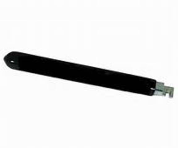

wallfish 20,056 #12 Posted July 14, 2016 2 hours ago, Racinbob said: I definitely will be getting a pair of those pliers. Me too. This is the type of Z bend tool I've always used but the pliers look like they make a nice sharper bend. 5 Share this post Link to post Share on other sites

CasualObserver 3,416 #18 Posted July 15, 2016 3 hours ago, T1257 RETIRED WRENCHER. said: Jason. I Just bought one Thanks I look at the video on U tube. Easy pezzzzse. No more hassling with plyers and needle nose. Thanks Hope you have a junk throttle cable laying around.... you're going to practice when you get it.... trust me! I threw away a couple of little stair stepped wires after I got them! I'd imagine in a couple days this thread will be back at the top when all you guys get the pliers and come back to say "why the heck did I wait so long to find this tool?" I fought for years with the needlenose/vicegrips and such, then looked at the cheap z-bender tool... thinking I'd get one... but then I saw a set of these and had to have them. one pinch, perfect z-bends. Never regretted the purchase. 11 hours ago, JimD said: Where did you guys but those tools if I may ask? I got mine off Amazon, but you should be able to find them at a local hobby shop too. The kind that deals in radio control aircraft and such. Those other kind like John posted the pic of are available by order at jacks small engines or tulsa engine warehouse.... or probably your local auto parts store. Tulsa Engine (tewarehouse.com) has three listed... Stens part number 750-455. Oregon part number 42-455 and off-brand 95-2061.... same tool at three different prices! All cheaper than the pliers, but I think the pliers are worth the extra few bucks. Easier to make a bend in the exact direction you want. 2 Share this post Link to post Share on other sites
