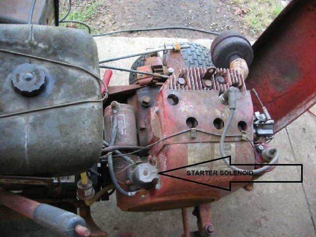

jnbimplements 1 #1 Posted May 26, 2016 I have an Electro 12 Automatic tractor. I want to ask where the starter solenoid should be mounted because when I got this tractor the solenoid was not on there? Also there is no starter button or starter key switch. Which should it have, key switch or push button for starter ? Any pictures will be greatly appreciated. Thanks, John Share this post Link to post Share on other sites

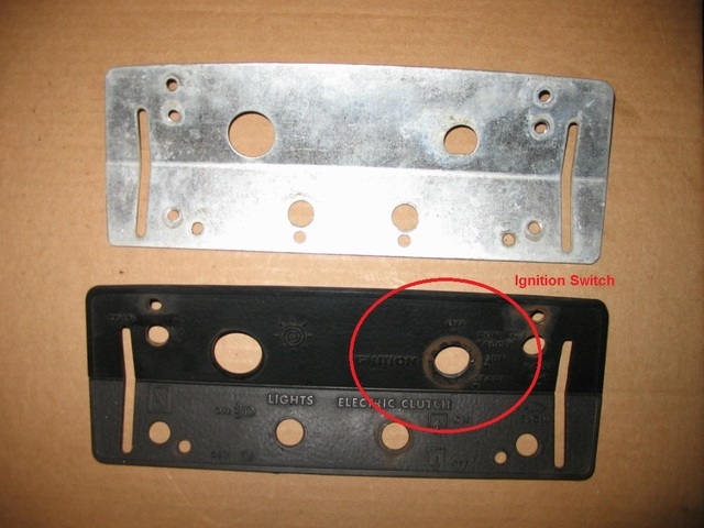

daveoman1966 3,619 #2 Posted May 26, 2016 Here is aB-100 with 10hp kohler.... Your tractor should have an ignition switch. I may have one...... For details, send me an off-site email (off of this forum) my emailo is: daveoman@windstream.net 1 Share this post Link to post Share on other sites
pfrederi 17,164 #3 Posted May 26, 2016 Some Electros used the heavy duty ignition switch...no solenoid, starter motor current went directly through the switch. The switches are not common and are costly. Going with a solenoid is a much better idea. Share this post Link to post Share on other sites
