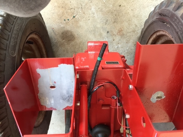

Tuneup 1,459 #1 Posted May 24, 2016 Hi gurus, Nearing the end of the restoration and this 1980 C-125 tank under the seat has seen fit to start leaking and peeling the fresh paint beneath it. Maybe I tightened the base bolts too much - maybe the fuel in the tank sitting for several days finally found a path through. Anyone face this before? I placed it on the bench and both sides leak, one of them much more than the other. I teflon taped the bolts as a test to eliminate that path but it bleeds through the seam around the metal fitting. I know it's redneck of me but am thinking of placing a gasket around the bolts and living with it. Thoughts? I haven't priced a tank - don't know if they're even available. eBay would be a crap shoot. Many thanks! Share this post Link to post Share on other sites

Tuneup 1,459 #7 Posted May 24, 2016 The leak bleeds from around the base screw fittings. I don't think it can be repaired - just wondering if anyone had the same problem and what they did to repair it. A nice big rubber sheet will solve the problem Share this post Link to post Share on other sites

Tankman 3,528 #9 Posted May 24, 2016 Be sure to gasket at the tank and under the bolt head. Gasket will not work, gaskets will. Fuel will follow the bolt threads. Use pipe sealer on the bolt threads. 1 Share this post Link to post Share on other sites

refracman 167 #11 Posted May 24, 2016 The tank is not designed for the bolts to extend into the tank, the correct bolts used to fasten it are only 1/2 in long. Is it possible that the wrong bolts were used? I would suggest you obtain another tank. Share this post Link to post Share on other sites
Tankman 3,528 #12 Posted May 24, 2016 Thanks Tuneup. Been working on chemical tanks for 40+ years. FYI. Small holes or cracks in PE (polyethylene) can be repaired, weld or use a soldering gun and slowly melt the PE. Keep the weld tight after you remove the heat, cools and will set fast. Done. 2 minutes ago, refracman said: The tank is not designed for the bolts to extend into the tank, the correct bolts used to fasten it are only 1/2 in long. Is it possible that the wrong bolts were used? I would suggest you obtain another tank. Careful, bolt lengths! Fender mounting bolts, topside, will also damage the PE tank. Share this post Link to post Share on other sites
Tankman 3,528 #13 Posted May 24, 2016 I have put bolts in tanks from the inside. Flat washer welded underside of bolt head, gasket on the bolt flat on the washer. Fished into the tank, threads out of the tank. Done. Share this post Link to post Share on other sites
