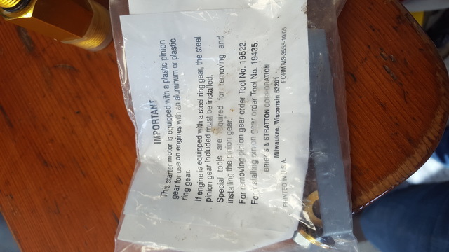

Howie 900 #5 Posted May 23, 2016 The steel gears were generally used when the ring gear on flywheel was plastic or what ever they call it. All of the starters used the same style gear at least on the single cylinders and some twins. Dave Share this post Link to post Share on other sites
Lane Huls 146 #6 Posted May 23, 2016 So get this. I get to work today, and a guy I work with says, I brought you a couple starters and some other parts. Hands me two exactly same starters like the one I have, a coil and an extra steel gear for these starters. All which have good gears. One is plastic. Now the extra steel gear had this to say 1 Share this post Link to post Share on other sites
