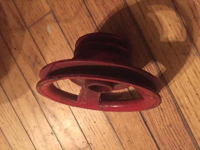

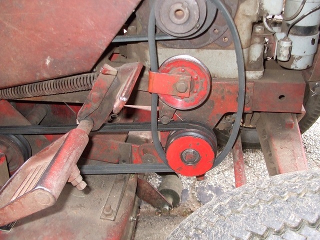

953 nut 69,839 #2 Posted May 22, 2016 If the deck on your 876 is the type that has the two gear drive spindles and a foot operated clutch then you would have to do a bit of shade tree engineering. If it had the "Bell" shaped clutch operated by a rod then you are in good shape. A picture of the mower clutch would help. A later model rear discharge deck would work if you have a mule drive mounted to the front to route the belt to the mower. Show us what you are working with and we can come up with a workable solution. Nothing is impossible with a . 2 Share this post Link to post Share on other sites
rubes 5 #3 Posted May 22, 2016 Thanx Richard...I thought I was a member here already, but couldn't log on with what I thought my username and PW were, so had to create a new account. The 876 and 877 both have the foot operated clutch (see attached) and gear drive spindles. the 1277 does have the bell shaped clutch. picture from CL ad I have not gone to look at it yet, just doing some background checking before doing so. I'm sure the seller is on here if he has a Horse. Looks to me like maybe I can just bolt the foot operated clutch to the frame of the 1277 and be good to go?? The 1277 manual does state the 36" RL-367 as an optional deck. I believe mine is an RM-367? whats the diff?? Rubes by the way...THANK YOU for your Service. 3 Share this post Link to post Share on other sites
953 nut 69,839 #4 Posted May 23, 2016 The foot clutch on the 877 should be easy to transfer over to the 1277, unbolt the needed parts from one, bolt to the other. You might have to get a new pulley for the engine of the 1277, pretty sure it is 1 1/8" and the 877 would be 1". Push come to shove you could find what you need at WW Grainger or McMaster-Carr. 2 Share this post Link to post Share on other sites

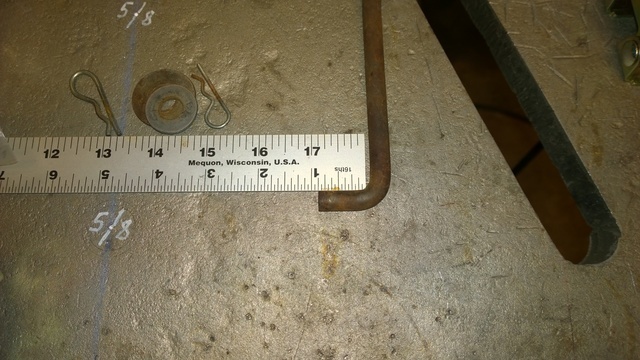

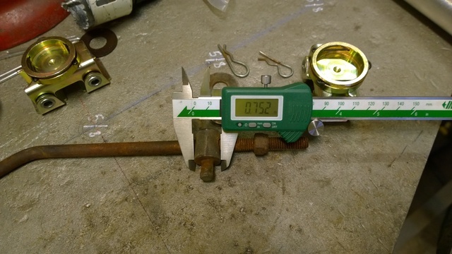

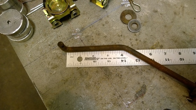

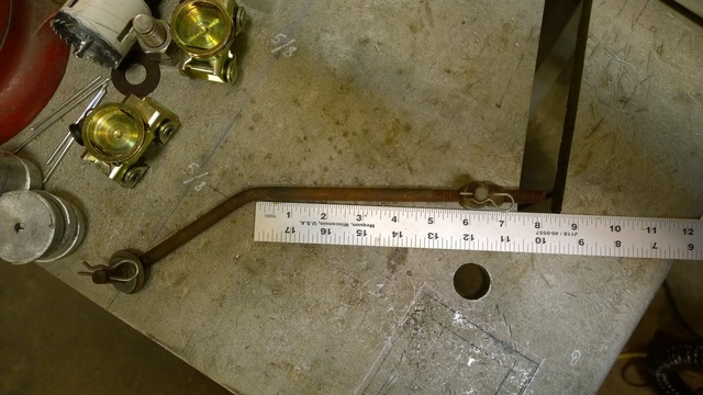

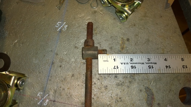

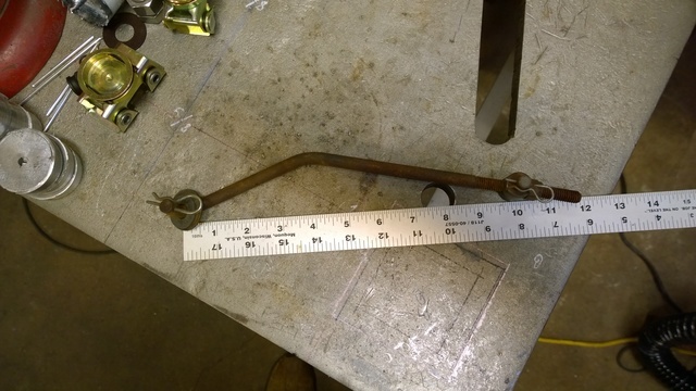

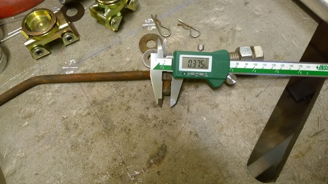

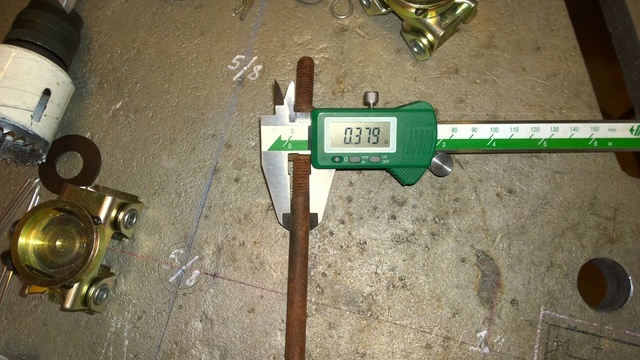

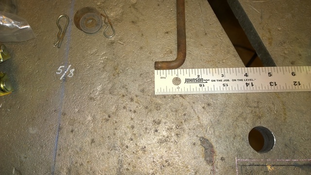

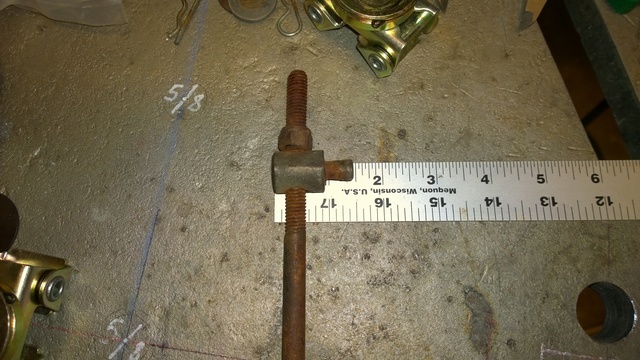

Sarge 3,473 #13 Posted June 10, 2016 Not a problem , glad it went to a good home and not going to get parted out . Now , for the benefit of all - here are photos and dimensions to make the bent style lift link . This is used when upgrading older 60's tractors using the RM series decks to later mule drives and decks . Doing this allows the use of all the more modern attachments without having to make adapters . Just source the following - Mid attach - some don't need it , but the more modern version is nicer . Front quick attach - there are drawings out there to make these, or just hunt Ebay or CL Clutch assembly - there are several versions , 1" crankshaft sleeve , 1-1/8" sleeve and several different diameter clutches . The smaller ones are 8hp , medium are the 10-12hp and the largest diameter fits the 14-16hp K series . It can be a bit tricky to get the correct rod standoff for the engine block end - again , not a hard part to make . Clutch rod and bracket - almost every 60's tractor had two holes on the right side of the hood stand to allow later parts Mule drive - find one with a good set of pulley bearings , some bearings can be replaced , others the whole pulley must be sourced . Best to use genuine WH parts here or Toro - last much longer . Once you have these parts , just takes a deck - I prefer the MS series such as MS42-01 or MS48-01 early 80's . Simple, abundant and repairable spindles . Even early double D spindles can be adapted to these decks are very rugged cast iron/steel . You can also easily use later model front and mid attachments , almost anything made for WH will fit using this newer quick attach system . See attached pics for dimensions - Sarge 1 Share this post Link to post Share on other sites

AMC RULES 37,260 #15 Posted June 10, 2016 Any one of these here... http://www.wheelhorseforum.com/store/category/1-redsquare-support/ should fix your pict posting issues. Share this post Link to post Share on other sites
Sarge 3,473 #16 Posted June 21, 2016 Try again - Sarge 1 1 Share this post Link to post Share on other sites
