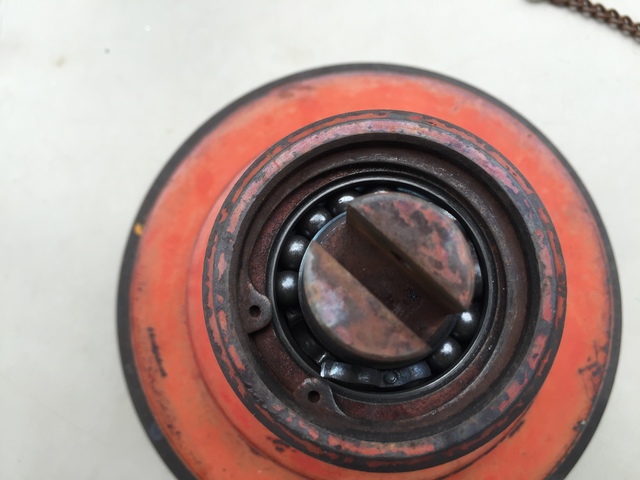

ClassicTractorProfessor 5,455 #1 Posted May 22, 2016 Was mowing today with my 1277 and noticed I have a bearing going out on my pto...anyone know where to get this bearing or what size it is so I can get it replaced? Share this post Link to post Share on other sites
gwest_ca-(File Mod) 12,483 #2 Posted May 22, 2016 Bearing Ball 109842 Replaces 31-0530, 310530, 251-351, 251351, 5196, 11080, 106947, 241100, 700496 .750"x1.781"x.610" Napa 7-04250, Rotary 484, Stens 230-033, Stens HD 230-037, Fafnir 204RR6, Generic 9504AB Garry 4 Share this post Link to post Share on other sites
ClassicTractorProfessor 5,455 #3 Posted May 22, 2016 Thanks Garry I didn't realize the pto had its own separate manual...that explains why I couldn't find it in any of the ones I had 2 Share this post Link to post Share on other sites
