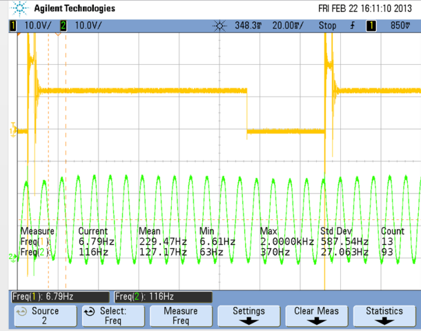

Save Old Iron 1,573 #6 Posted May 24, 2016 (edited) On 5/22/2016 at 6:50 AM, Tuneup said: You don't have a beautiful sine wave coming out of the stator I don't know what a "beautiful" sine wave looks like but here is what the stator output (bottom trace) and points side voltage trace (upper trace) look like on an average WH charge / ignition system (thanks Mark!). No unusually high crest factors here, the quality is good enough for a tachometer to register correct RPM's on a 520. So long as the users meter is not defective, we should see a steady reading. On 5/22/2016 at 8:14 AM, jst1more said: Thanks guys, I never thought about my digital meter being the culprit. I don't believe we ever asked what brand / model of meter you were using. If you set it to AC Volts and measure a wall outlet in your home, you should see a steady 115 to 120 VAC. Some less expensive meters are poorly shielded against radio frequencies - such as the radiation interference from a solid core spark plug wire. Edited May 24, 2016 by Save Old Iron 2 Share this post Link to post Share on other sites

Save Old Iron 1,573 #8 Posted May 24, 2016 5 hours ago, Save Old Iron said: Some less expensive meters are poorly shielded against radio frequencies - such as the radiation interference from a solid core spark plug wire. If the AC Volt functions OK with the wall socket test, try twisting the meter leads into a braid, place the meter on the ground as far from the spark plug / wire as possible and take the readings again. The meter leads are most likely acting as an antenna and the spark plug wire as a broadcast station (very similar to the interference picked up by an AM radio when held near a fluorescent light). I use Fluke 87 III meters routinely and have not noticed any interference issues when checking open stator leads - I always lay my meter on the ground and not on the engine tins or near the ignition system.. At full throttle, the spark plug fires 60 times per second and the stator design produces 18 AC cycles per spark - so the stator is about 1000 to 1100 HZ - well within the capability of a decent digital meter. 2 Share this post Link to post Share on other sites
