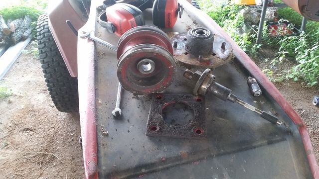

nws024 0 #1 Posted May 21, 2016 I'm back. I received alot of help with my clutch problem, thanks for that. Aparently my dad and I did not put grease in the center pulley, nor did previous owners by the looks of the bearing. The pulley snapped and came off. I have pulled it apart and I think it all needs to be replaced. I can take pics if that will help. I need ideas for replacement parts. Toro dealer claims they might be able to match. My tractor is C195. Sometimes tough to find parts. Thanks for y'alls help Share this post Link to post Share on other sites
