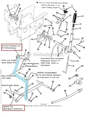

theprojectprospector 11 #1 Posted May 21, 2016 Question, I have a 312-8 with a mower deck when I bought the tractor the mower deck didn't raise or lower,I recently took the deck off to discover a chain that wasn't hooked up when I hooked it up the deck worked opposite when I went to raise and would lower. How would I switch this? I notice it has plow mounts so somebody at one part of its life had a plow hooked up. (Also hopefully I posted in the right place.) Share this post Link to post Share on other sites
daveoman1966 3,882 #2 Posted May 21, 2016 (edited) You have something connected wrong. Look CLOSELY at this schematic to show where / how the mower lifts. Note the lower left corner.. NOTE... I've modified this schematic to show the lift linkage for the mower deck .....shaded in blue. Edited May 22, 2016 by daveoman1966 modified schematic 3 Share this post Link to post Share on other sites
953 nut 65,234 #3 Posted May 21, 2016 Did your lift chain happen to get routed over part # 19 in Dave's drawing? That would make it operate backward. Share this post Link to post Share on other sites
cheesegrader 436 #4 Posted May 22, 2016 It would also work backwards if the lift chain is mounted on the back of the rockshaft, in one of the holes for the snowblower, generator or rear lift cable. 1 Share this post Link to post Share on other sites

Racinbob 12,896 #6 Posted May 22, 2016 Can you post a picture of how it's hooked up? Your situation seems almost impossible. The chain would have to be routed over the shaft as Richard mentioned but I just don't see how that could happen. Share this post Link to post Share on other sites
Tankman 3,528 #7 Posted May 22, 2016 Impossible to visualize? Looking forward to your findings 'cause your problem doesn't compute. Any pic's? #'s 54 & 55 aren't on any of my Horses lifts but, might be a good idea. 1 Share this post Link to post Share on other sites
