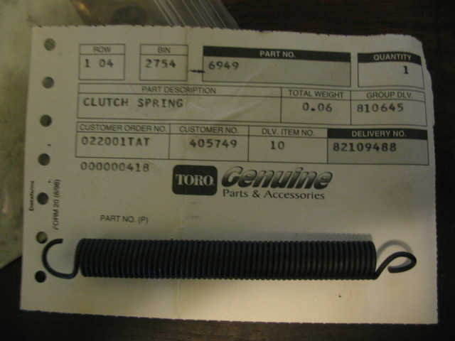

daveoman1966 3,884 #2 Posted May 20, 2016 Here is a NEW clutch spring # 6949. Tip to tip is 4 1/2" long. The coil is 3 1/2" long and the spring is about 1/2" dia. for further details, contact my DIRECT EMAIL, which is: daveoman@windstream.net 1 Share this post Link to post Share on other sites
