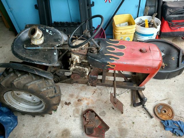

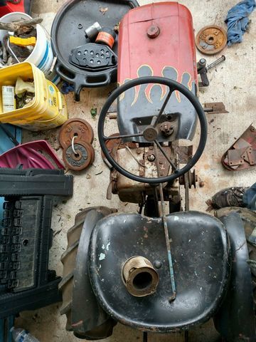

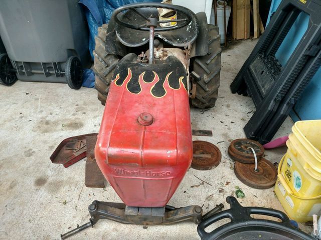

Vinylguy 4,797 #1 Posted May 20, 2016 I have a customer who is new to Wheel horse ad needs to find out what he has and what has been modified. All help is appreciated. Larger images 3 Share this post Link to post Share on other sites

AMC RULES 37,260 #3 Posted May 20, 2016 (edited) Tecumseh engine... 551's my best guess. Hood stand/battery box don't look right though. Edited May 20, 2016 by AMC RULES Share this post Link to post Share on other sites
WHX?? 58,347 #4 Posted May 20, 2016 Close AC dude... 1961 401 Sub...Highly modified hood is anyway. I don't think that engine is orginal AMC, Seat pan looks like it might have been on a 59 RJ or early 400 Share this post Link to post Share on other sites
Racinbob 13,286 #5 Posted May 20, 2016 I'm going with a 60 Suburban. The engine isn't original which is why the hood was cut up. Obviously we can't tell by the throttle/choke controls but the footrest is a 1960. 1 Share this post Link to post Share on other sites
WHX?? 58,347 #6 Posted May 20, 2016 (edited) I was looking at the front of the dash Bob ... the two holes? I would think '60 some of the throttle/choke cut out would still be there?? Hood didn't get Racinbobbed ... .. tht much Edited May 20, 2016 by WHX61/3 Share this post Link to post Share on other sites
CasualObserver 3,417 #7 Posted May 20, 2016 Sorry Jim. I'm with Bob on this one... tractor has 1960 foot rests.... makes it more likely to be 1960. A PO probably used the top squared off edge of the throttle cutout to start the cutting off of the hood. Easy to have two holes in the hood... my 400 has two.. one original, one not. 1 Share this post Link to post Share on other sites
Racinbob 13,286 #8 Posted May 20, 2016 Good point Jim. Ya made me run out to the garage and measure. 2 3/4" from the top of the cutout to where it starts sloping up. It's hard to tell in the picture. I'm thinking like Jason on that being the starting point for the hack. I've got the hole on the right. Share this post Link to post Share on other sites
WHX?? 58,347 #9 Posted May 20, 2016 I agree with the foot rests .... are we saying the two holes I have circled arn't orginal then? Share this post Link to post Share on other sites
CasualObserver 3,417 #10 Posted May 20, 2016 A very close inspection reveals the top screw hole where the choke/throttle was bolted on 1960. The cutout was just below that. 1 Share this post Link to post Share on other sites
Racinbob 13,286 #11 Posted May 20, 2016 Now that there is called a good eye. Share this post Link to post Share on other sites
WHX?? 58,347 #12 Posted May 20, 2016 Holy Smokes that an old school light switch on there!!! Now why didn't my blow up save like that!?!?!? Agreed ther Bob! Share this post Link to post Share on other sites
CasualObserver 3,417 #13 Posted May 20, 2016 only the right hole is original. Left one was drilled or punched later, it's also smaller. Here's mine with the original plug in the right side. Don't have any showing the hardware toggle on/off switch the PO put on the other side. Share this post Link to post Share on other sites
WHX?? 58,347 #14 Posted May 20, 2016 I see ...I guess whats throwin me is my 400 has no holes at all up there. Well 60 might explain the solid seat pan?? Share this post Link to post Share on other sites
Racinbob 13,286 #15 Posted May 20, 2016 From what I've seen it's just about a 50/50 mix on that hole. Later on in the 60's they probably only made them with the hole for replacements so they could go o either year. As far as the seat, I tend to believe the original parts list and it shows the 2510 seat with holes but I would say there's no doubt that they came out of the factory both with and without. I just now noticed something in the 60 Suburban owners manual. Item # 4 under "All Aboard" Starting my engine: Pull retractable starter cord on engine. Or push starter button (optional equipment). Interesting. 1 Share this post Link to post Share on other sites
stevasaurus 23,884 #16 Posted May 20, 2016 Only 1960 came with flames on the hood. 6 Share this post Link to post Share on other sites

TDF5G 2,074 #18 Posted May 20, 2016 12 minutes ago, stevasaurus said: Only 1960 came with flames on the hood. and the black seat and fenders and silver wheels. 3 Share this post Link to post Share on other sites

wallfish 20,733 #20 Posted May 20, 2016 1960 400/550. The hood is 1960 and the clutch pedal is 1960, plus the added support of the 1960 foot rests and the solid seat pan. 1 Share this post Link to post Share on other sites
russellmc301 601 #21 Posted May 20, 2016 i think began life as a 400 then techy was added wall fish seems right. Share this post Link to post Share on other sites
