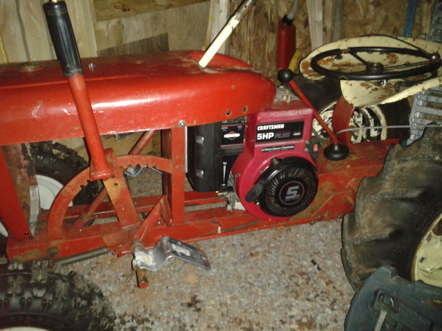

peigt14 19 #1 Posted May 20, 2016 I have a little 401 that I bought with a little hs40 Tecumseh engine mounted on it, wasn't running for years when I purchased, spend some of the winter rebuilding carb, new points, new condenser, new coil, etc. etc, it now runs but is difficult to start and runs a little rough, leaking some oil around, anyways long story short I am looking for something to mount to this so my son can use it while continue to get the hs40 running properly, I tracked down a good running cheap 2.5 hp briggs that looks like it will fit well, exhaust is in good place away from leg, Question is will this be enough power to move him/possibly me around the yard? If not any suggestions on what works well for these. I have looked at few 5 hp Hondas but seem to large, some 3.5 hp Hondas size seemed ok, exhaust seemed good but they were from pump and had a gear reduction. Share this post Link to post Share on other sites

peigt14 19 #9 Posted May 26, 2016 got lucky and found a newer 5 hp briggs, little tighter then the hs40 but bolted right in, had to cut a small notch in the backside of the hood as it was sitting right on the plug wire but other then that pretty happy, One more quick question what is the size and thread of the 4 bolt holes around the shaft? I have to work get something worked out to disengage the belt with Share this post Link to post Share on other sites
