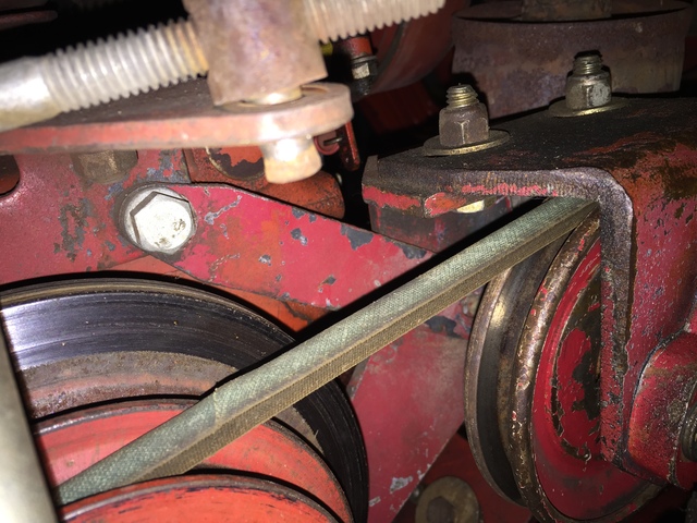

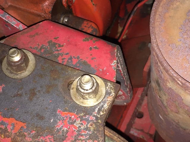

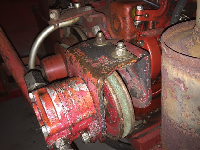

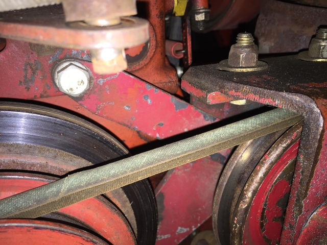

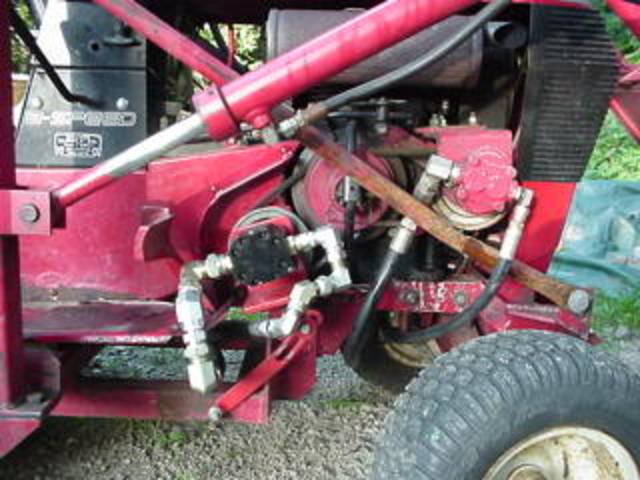

hondagod64 81 #1 Posted May 18, 2016 GOOD MORNING...I NEED SOME HELP ON THE PROPER MOUNTING OF THE PUMP TO THE ENGINE FOR A WHEELHORSE ARK LOADER. I HAVE A 79 C-121-8 WHEELHORSE TRACTOR THAT I BOUGHT SEVERAL YEARS AGO WITH A ARK FRONT LOADER THAT WAS SEPERATED WHEN PURCHASED. I FINALLY GOT TO RE-ASSEMBLE STAGE TO MOUNT BACK TOGETHGER AND WAS WONDERING IF ANYBODY HAS PICTURES SHOWING HOW THE PUMP ASSEMBLY GETS MOUNTED BACK ON THE SIDE OF THE MOTOR. I HAVE THE ALL BRACKETS FOR THE MOTOR AND THE 1 BRACKET IS STILL ATTACHED TO THE PUMP. THE NUMBERS ON THE TRACTOR ARE 91-12K802 AND THE LOADER IS 97-40FLO1. Share this post Link to post Share on other sites

hondagod64 81 #3 Posted May 26, 2016 56 minutes ago, MalMac said: Did you ever get it figured out? If not I have some pics on another computer I can try and post for you. Yes and no...I have the one bracket attached to the motor which holds the pump but don't know what this short bracket mounts to too...maybe 4-5 inches long....any pics for this mounting would be great....just want to have it right so I don't have any issues Share this post Link to post Share on other sites

MalMac 1,336 #5 Posted May 26, 2016 Ok I went to get the pics off the computer but for some reason it will not let me open them. I have to get some other pics for you. Don't know if it will be today or not. Busy time here on the farm. I have to go to where the loader is at. Share this post Link to post Share on other sites
hondagod64 81 #7 Posted May 26, 2016 Outstanding!!!!!!!!!!!!!!!!.....perfect pictures....Now I know how this gets mounted.....I feel like a dummy after seeing these pics....I thank you so much for doing this for me and also taking the time out of your busy day....Thank you so very much!!!!!!!!!!!!!!!!!!!!!!!!!!!!!!! 1 Share this post Link to post Share on other sites
