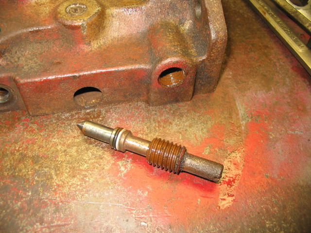

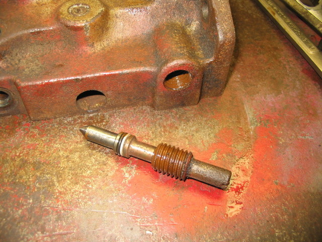

Thisguyisnew 114 #1 Posted May 18, 2016 Bought a c-160 that was sitting for many years in a shed. After installing a new condenser and adding some gas fired right up. Minor work later and it has been my main mower ever since. I can't enough about this tractor. Except the tow valve is stuck solid. Trust me when I say it's stuck. I believe this is very common and don't seem to have a need for it now but would like the option. Besides penetration oil and extreme patience would any of you know of any other safe methods to bust this loose? Thanks in advance. Share this post Link to post Share on other sites
daveoman1966 3,884 #2 Posted May 18, 2016 This TOW VALVE / PUSH VALVE is in a really awkward place on the left side...hard to get to and a long broad flat screwdriver doesn't always work. If you can find VISE GRIPS small enough to get onto the valve stem is a better way. With the vise grips VERY TIGHT on the valve stem, give the grips a quick WHACK.....rather than applying a lot of brute force. The quick WHACK should break it loose. Here is what it would look like apart: 3 Share this post Link to post Share on other sites
Thisguyisnew 114 #3 Posted May 18, 2016 Thanks, your pic I think will be the most help to me as I was assuming too much was involved on stem end that might break inside. Tried all that you suggested before but I might try with a bit more confidence. Another good well placed blow is in order I think. Thanks again as I knew I came to the right place. 1 Share this post Link to post Share on other sites
