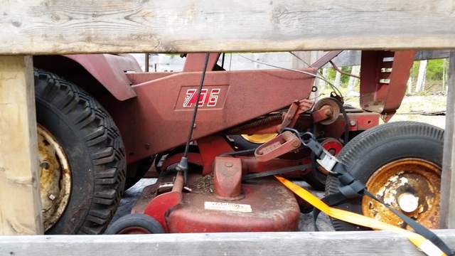

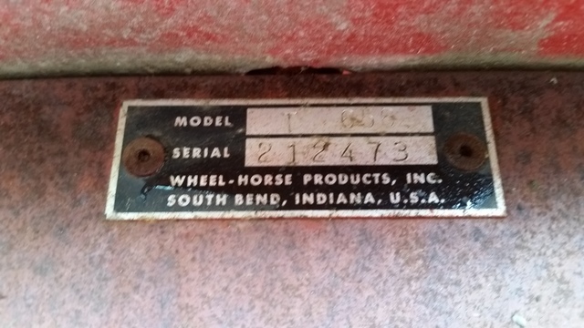

nhmikel 14 #1 Posted May 18, 2016 (edited) Year? Hp? Engine make?, etc picked these up today along with 1960 suburban and deck.Which engine model and hp will fit? Edited May 18, 2016 by nhmikel 4 Share this post Link to post Share on other sites

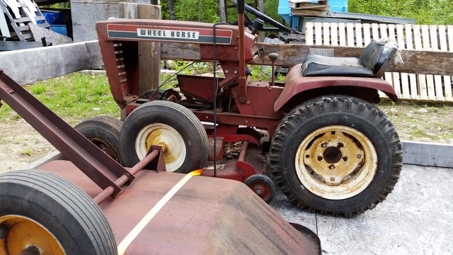

SylvanLakeWH 31,051 #2 Posted May 18, 2016 Nice! Folks with a lot more wisdom will answer your Q's... What's the black hood WH in the background? Is it a "C"??? Share this post Link to post Share on other sites
953 nut 65,165 #3 Posted May 18, 2016 The tag said it all; you have a 656, had an electric start six horse power Kohler when it left the factory in 1966. A previous owner seems to have put a few incorrect decals on it over the years, no such thing as a 706 as far as I can find. perhaps a previous owner put a pull start seven horse engine on it. 1 Share this post Link to post Share on other sites
wallfish 19,723 #4 Posted May 18, 2016 (edited) Tractor looks like a hybrid, that hood doesn't look right. You seem to be after every WH in the area so this document will help you Wheel_Horse_All_Years.pdf Edited May 18, 2016 by wallfish 1 Share this post Link to post Share on other sites
953 nut 65,165 #5 Posted May 18, 2016 14 minutes ago, wallfish said: hybrid, that hood doesn't look right. I think all of the short frame '65, '66 and the six and eight horse power '67s had the same hood. The decal is not what was being used at this time, but the hoods from later long frame s would not fit a short frame. Hard to tell what might have been altered over a half century of owners. Share this post Link to post Share on other sites
gwest_ca-(File Mod) 12,138 #6 Posted May 18, 2016 There was a 706 but thought it was an exported model Garry 1 Share this post Link to post Share on other sites
953 nut 65,165 #7 Posted May 18, 2016 2 hours ago, gwest_ca said: There was a 706 I was going by the "All Years" list, always exceptions to the rules with 1 Share this post Link to post Share on other sites
CasualObserver 3,415 #8 Posted May 18, 2016 That is curious. Everything I've seen about the 706 is that it was a US built export only model and all the 706 models that have turned up so far have been overseas as far as I remember. Clearly the serial tag says its a 656. Occam's razor would say it accidentally got a wrong belt guard decal while going down the line. It is well documented that multiple models ran in batches down the same assembly lines at the factory. A wrong decal on the belt guard would not be an unbelievable mistake. And the 656 would have been an 6HP Tecumseh, not a Kohler. Share this post Link to post Share on other sites

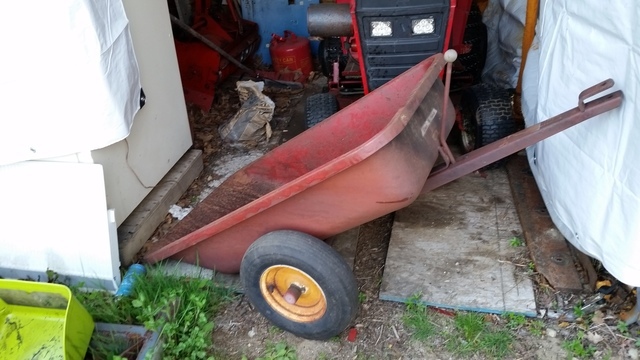

Racinbob 12,891 #9 Posted May 18, 2016 Interesting. Nice cart too. Here's a good cross reference for the engines. Share this post Link to post Share on other sites
nhmikel 14 #10 Posted May 18, 2016 Is it safe to assume the hoods of different lengths will interchange? How can you tell what year this one is? Share this post Link to post Share on other sites
CasualObserver 3,415 #11 Posted May 18, 2016 Not all. For those 60s wedge hood models, there were long frame and short frame... I think they're about 4" different. Your tractor model ends in a 6, making it a 1966. The lower (6-8) HP models were the short frames and the higher (10-12) were the long frames. If you want a different hood, it needs to come from another short frame model between 65-69. 1 Share this post Link to post Share on other sites
psalms83:18 174 #12 Posted May 18, 2016 22 hours ago, SylvanLakeWH said: Nice! Folks with a lot more wisdom will answer your Q's... What's the black hood WH in the background? Is it a "C"??? yeah that's my c-175 pulled from beneath a dirt pile 22 hours ago, wallfish said: "" You seem to be after every WH in the area "" actually we are trying to be picky about which ones we get....but wheel horse up here is Rare compared to Indiana Pennsylvania and other areas, so being in the buying mood does kinda drum up the idea of consider anything that is wheel horse.... we are sticking to arch fenders ...what we want next is a D model not with an onan with pto and 3 point...and an rj. 2 Share this post Link to post Share on other sites
nhmikel 14 #13 Posted May 18, 2016 The C was a free item and my son did all the work of cleaning, replacing and tuning it up. Job well done Adam 1 Share this post Link to post Share on other sites
wallfish 19,723 #14 Posted May 19, 2016 4 hours ago, nhmikel said: How can you tell what year this one is? 6=6hp 5=electric start 6=1966 A 7 or 8hp kohler will fit on that too but has to be a starter/generator type engine so the battery fits. Or go just pull start. Funny that it has a 706 sticker and there isn't a battery tray in there. The battery tray sits right in front of the steering sector for electric start models. Share this post Link to post Share on other sites

wallfish 19,723 #16 Posted May 22, 2016 It appears to be complete except for the items you mentioned but don't know if there's a gas tank in there. An original Tecumseh powered tractor would've used a tank that was connected directly to the engine but any Kohler powered models would have a tank sitting in the tray under the hood right behind the dash. Personally I would go with a Kohler 7 or 8hp. A nice K161 7hp pull start should fit right in there. With a good clean carb they start right up with one or two pulls so not a big deal without electric start. Plus there's no expense of the electrical parts needed or a battery. It will match that decal on the belt guard too. Flushing the trans with diesel or kerosene will get most of the old oil and crude out of it and then fill with gear oil like SAE 90-140 API GL-5. Most of the time it's easier to pull the shifter out to use that big hole to fill it. I've been "eyeballing" that cart in your pictures and have an engine and tank if you might want to trade. Either electric start 8hp or a 7hp pull start with the pulley and we can work out the details for either one. Share this post Link to post Share on other sites

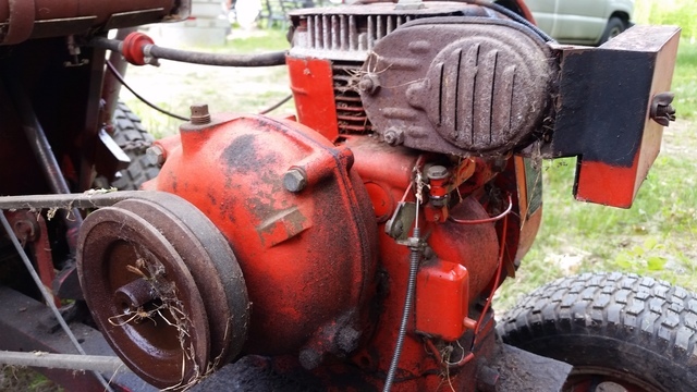

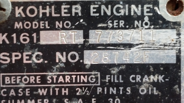

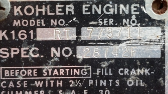

nhmikel 14 #17 Posted May 23, 2016 Will this engine fit my 656? Share this post Link to post Share on other sites
CasualObserver 3,415 #18 Posted May 23, 2016 The 7 HP Kohler would be a good choice, but I'd stay away from that one if you're looking for a bolt-on solution. That big bell housing on the PTO side is a gear reduction unit, those engines are typically used more for pump motors that need slower RPMs at full power. Inside there, the crankshaft is splined to run a ring gear to low the RPMs. You'd have to remove that and change the crankshaft from the splined shaft to a keyed shaft. 1 Share this post Link to post Share on other sites
RedRanger 1,470 #19 Posted May 23, 2016 4 hours ago, CasualObserver said: The 7 HP Kohler would be a good choice, but I'd stay away from that one if you're looking for a bolt-on solution. That big bell housing on the PTO side is a gear reduction unit, those engines are typically used more for pump motors that need slower RPMs at full power. Inside there, the crankshaft is splined to run a ring gear to low the RPMs. You'd have to remove that and change the crankshaft from the splined shaft to a keyed shaft. OR drive real slow. 2 Share this post Link to post Share on other sites
