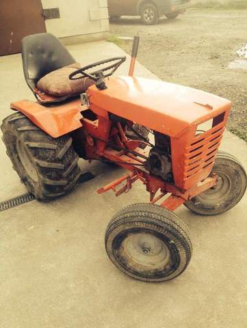

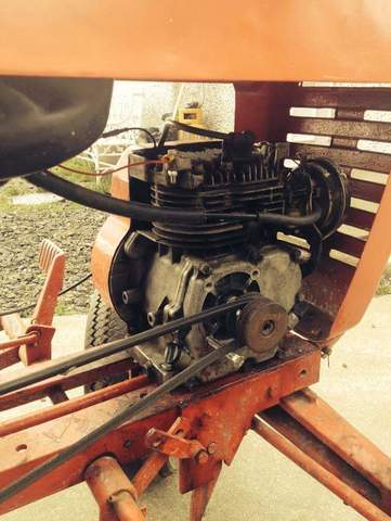

Cgoligher990 8 #1 Posted May 17, 2016 Watods could I do to this wheelhorse 4 Share this post Link to post Share on other sites

Racinbob 13,125 #3 Posted May 17, 2016 (edited) By any chance can you read the model number? The tag should be on the steering tower just under the dash. That steering was put on some of the 500 Specials made in 1968. Not conclusive but at least some evidence. Love the rear meats. You need a belt cover on it to stop the belt. Otherwise you will be grinding gears and damaging the transmission. Edited May 17, 2016 by Racinbob 2 Share this post Link to post Share on other sites
Racinbob 13,125 #5 Posted May 17, 2016 I just noticed you're from Ireland. Cool!! That could wipe out my thoughts on the steering wheel. 2 Share this post Link to post Share on other sites

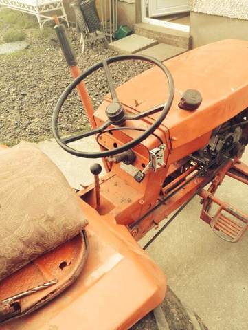

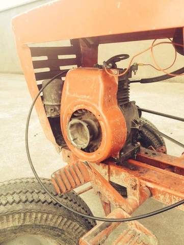

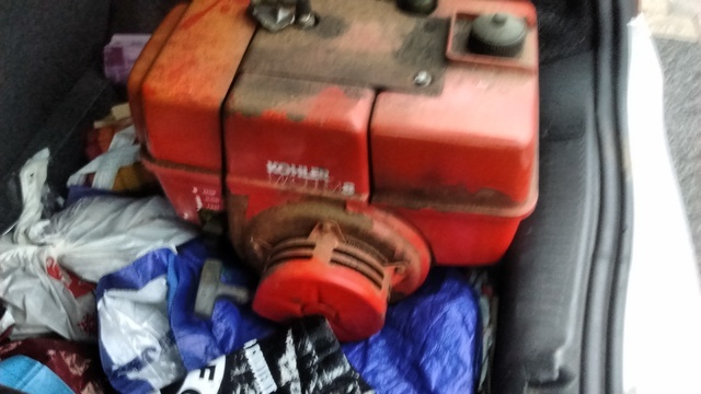

Cgoligher990 8 #11 Posted May 18, 2016 Here are some more pics (ino the engine is too small I have a Kohler 8hp I can put in it)so wat mods could I do too it 3 Share this post Link to post Share on other sites

ACman 7,741 #13 Posted May 18, 2016 endless possibilities . Put that 8hp to good use make whatever you want . We're not here to judge , we just want of what you do . So to your new project , and good luck . 2 Share this post Link to post Share on other sites

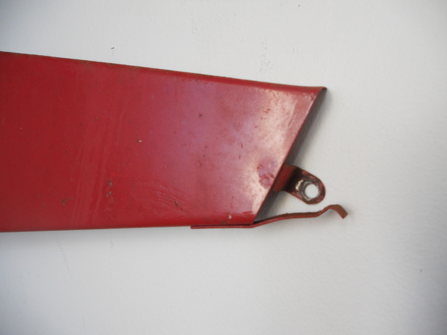

Cgoligher990 8 #16 Posted May 19, 2016 On 18/05/2016 at 5:40 PM, ACman said: On 17/05/2016 at 9:27 PM, Racinbob said: By any chance can you read the model number? The tag should be on the steering tower just under the dash. That steering was put on some of the 500 Specials made in 1968. Not conclusive but at least some evidence. Love the rear meats. You need a belt cover on it to stop the belt. Otherwise you will be grinding gears and damaging the transmission. Why would the gears grind without the belt guard ?? Share this post Link to post Share on other sites
ACman 7,741 #17 Posted May 19, 2016 Your brake/clutch pedal when pressed down doesn't stop the input shaft from spinning . The belt guard is designed so when you press down on the brake/ clutch pedal it keeps the belt from spinning the input shaft . Therefore the inards of the trans aren't turning and will shift into gear without grinding . Hope that makes sense . 3 Share this post Link to post Share on other sites
Racinbob 13,125 #18 Posted May 19, 2016 It accomplishes it's task by easing the belt away from the motor pulley. Depending on the model there's one or two tabs. These need to be adjusted properly. The manual will give you the exact distance they need to be from the belt when it is tight. As a rule of thumb I use 1/8". 2 Share this post Link to post Share on other sites
Cgoligher990 8 #19 Posted May 19, 2016 On 18/05/2016 at 5:40 PM, ACman said: . On 17/05/2016 at 9:27 PM, Racinbob said: By any chance can you read the model number? The tag should be on the steering tower just under the dash. That steering was put on some of the 500 Specials made in 1968. Not conclusive but at least some evidence. Love the rear meats. You need a belt cover on it to stop the belt. Otherwise you will be grinding gears and damaging the transmission. Ryt can I modify it in a way or put a tab or something 5 minutes ago, Racinbob said: It accomplishes it's task by easing the belt away from the motor pulley. Depending on the model there's one or two tabs. These need to be adjusted properly. The manual will give you the exact distance they need to be from the belt when it is tight. As a rule of thumb I use 1/8". Have u any pics its quite confusing I'm not too familiar with these wheelhorses Share this post Link to post Share on other sites
Racinbob 13,125 #20 Posted May 19, 2016 Here's one that will go on my 500 Special and is quite likely the same one you need.. The majority of them just have the bottom tab. That tab will be no more than 1/8" from the belt when it is tight and it will be under the motor drive pulley. Yes, you can add one if yours is missing. 1 Share this post Link to post Share on other sites
Racinbob 13,125 #21 Posted May 19, 2016 You really just need something that will ride the belt in the location of that tab. Some guys bend heavy wire to shape and use a bolt hole in the motor to hold it in place. 1 Share this post Link to post Share on other sites

Racinbob 13,125 #23 Posted May 19, 2016 No pictures but here's the idea. Every application is different. Just bent the wire to suit your application. 1 Share this post Link to post Share on other sites
