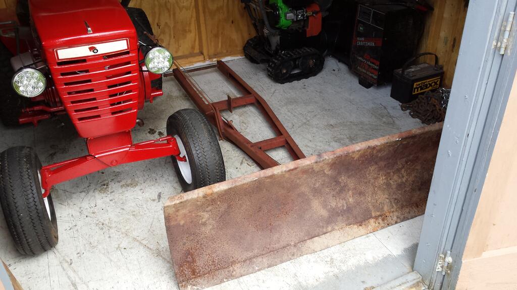

Thegearhead0324 1,857 #12 Posted May 30, 2016 Figured id post a pic. It's the 54 inch blade. I have it all torn apart for clean up and paint to match the horse. I ordered the bracket for the back rear end and new skid feet for the plow. Maybe in a week or so I'll have it on the horse all like new hopefully. 4 Share this post Link to post Share on other sites

stevasaurus 23,857 #16 Posted June 1, 2016 Your 1257 is a long frame horse...you want to use the last holes on the transmission end of the blade frame for mounting to the transmission. Your front tires may interfere with angling the blade if you use the "short frame" holes. The "C" series bracket will fit your transmission on your 1257. Nice looking blade. Share this post Link to post Share on other sites

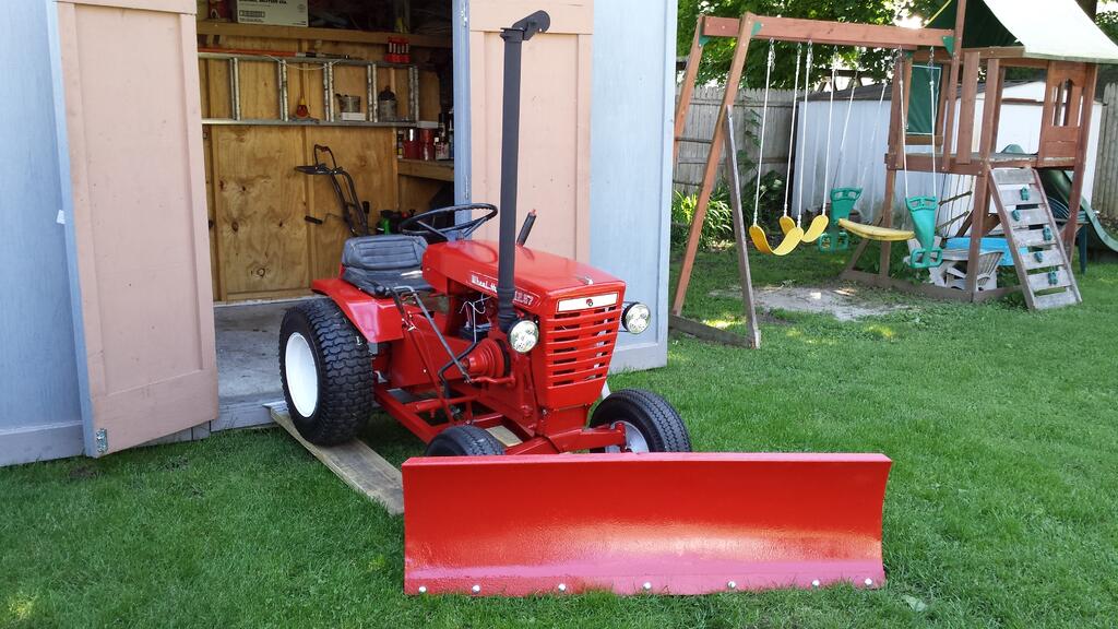

Thegearhead0324 1,857 #18 Posted June 2, 2016 All done. I tell ya that blade attachment is HEAVY! 54 inches and the blade has to be turned to just barely get out of my shed lol. But here it is... 3 Share this post Link to post Share on other sites

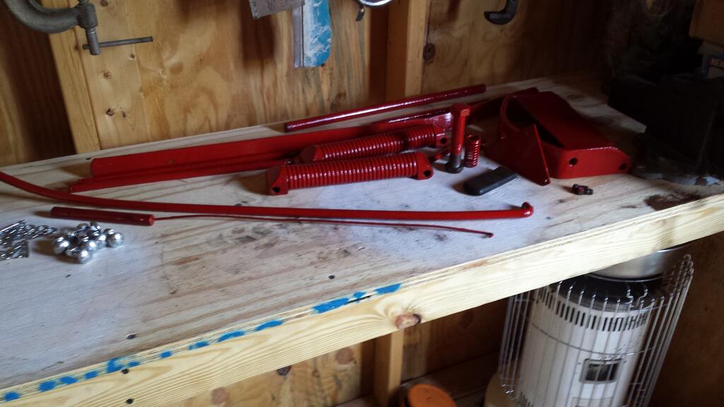

Thegearhead0324 1,857 #22 Posted February 14, 2023 Thought I'd bring this back from the dead almost 7 years ago, time flies. Anyways here are the pictures of that dozer/plow I redid and still have. I noticed the pictures weren't on here. Looking through them brings back memories. 5 Share this post Link to post Share on other sites
peter lena 10,090 #23 Posted February 14, 2023 @Thegearhead0324 looks good , the steering quadrant slide pin area , really responds to , a red grease lubrication detailing , also the lever squeeze grip , really responds to a tightening of the pull wire , for more direct movement / lubrication . makes that slide pin work and sound like a rifle bolt , 2 things , I lubricate the face of the plow with an aerosol lubricant , to stop rust and enhance , snow release , you might also think of adding a vertical spring pull , from the from end of the chassis , to help in plow lift . experiment with with extension springs , add on a couple of 3/8 EYE BOLTS , for your spring pull asist point . pete Share this post Link to post Share on other sites
