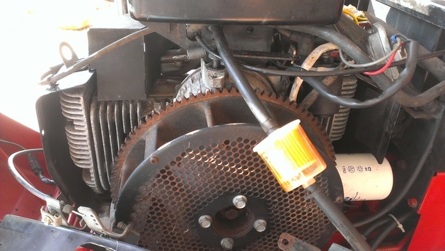

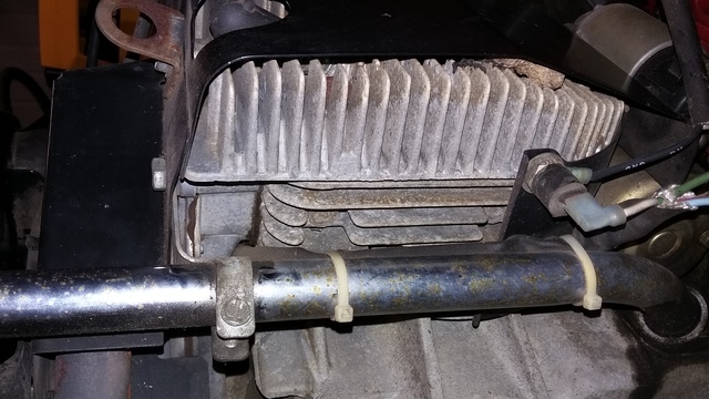

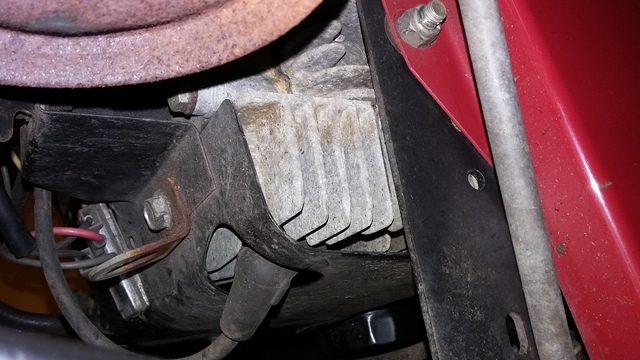

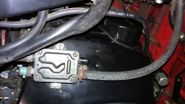

BOB ELLISON 2,983 #1 Posted May 14, 2016 Ok here we go again I have a 1995 520h that runs like a top and I want to clean the crap out of it. So to speak. I did check the right rear fins and they are clean, it's where everyone says to keep clean and some even cut vent holes for air. I did try to remove the blower housing where the flywheel is and where the fuel pump is . How do I get the hose from the back of the fuel pump off ?? Does any one know of a manual or a post to show how to remove all the tins for cleaning . I will replace all the gas lines and check all wires under tins while I got it off. A picture is worth a thousand words. Share this post Link to post Share on other sites
WVHillbilly520H 10,378 #2 Posted May 14, 2016 The engine tins are a bit of a pain but doable, the oil filter has to come out/off though ,some use a small steam cleaner to help with removal of the accumulated crud after the tins are off or out of the way, now the fuel pump take the screws out pull the pump outward with vacuum hose still attached should be a squeeze clamp like fuel lines remove that and you may have to pry hose off nipple then a bolt in the end of it till you get the tins loose when putting tins back you'll need some long needle nose pliers to help get it back out to the fuel pump, some of the tins are bolted with the muffler heat shields below the air cleaner, hopefully have helped not confused you, also while your at it take the fender pan off and clean that hydro pump and fins really good too I used a pressure washer for that, take a look at "Good Friday" 520 clean up thread, Jeff. Share this post Link to post Share on other sites

Gadget 37 #4 Posted May 14, 2016 You might wanna make some notes about how the throttle linkages are BEFORE you take it all apart. I had to remove the forward one (where the cable clamps) and the spring to the governor. I didn't have to take the oil filter off. Once you get everything loose, the cover kind of lift up slightly out, then down and to the rear. Reinstall in reverse order. On mine, some of the bolts holding the "tin" on were longer than the others, so you might want to make notes about which ones came out of which hole. After going thru all the effort of doing what you are doing, I found everything very clean. BUT it was a GREAT learning experience. For me anyway, being new to these machines, nothing makes me learn faster than taking something apart and putting it back together. At least now I know, as will you, that everything is clean and air is flowing as it should. I learned (I think) that the air flows from left to right, very basic for the more experienced guys here but not for me. I know that there are many posts about venting the covers and they make sense, but I am starting to think that when you vent the covers, you are making an exhaust port, I had thought they were intakes. Like I said, No way to learn other than breaking out the wrenches. Good luck 3 Share this post Link to post Share on other sites
