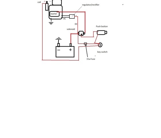

Wheelhorsestory 210 #1 Posted May 13, 2016 Hey Guys, I need help with some wiring. This is my week point! I need wiring for beyond dummies (LOL). I love the low sound of the Kohler so I searched and I bought a NOS Kohler K181 (Late 60ish) with the later starter and stator, not starter/generator. It also has an exterior coil and solenoid. I am putting this on my 1962 Lawn Ranger Project, "Straight From the Horse's Mouth " tractor. The engine has a wire harness coming out of it with two wires in a plug. My tractor has the old push button starter switch along with the on and off key switch with ampmeter. Can someone draw me a detailed wiring diagram that shows the complete set up. I greatly appreciate any help I can get. If you want to email me a diagram it is whrj35@aol.com. Also, I will have the original (very rare) Tecumseh H55D (electric start from a 32E) completely rebuilt with all NOS parts including the block. Its up and running, but you will have to tinker with the timing. After all it's a Tecumseh! Thanks, Mike Share this post Link to post Share on other sites
953 nut 70,667 #2 Posted May 14, 2016 Mike, you can use the stock starter button to activate the solenoid, just run a battery + wire to the button and a wire to the small terminal of the solenoid, these can both be small 16 gauge wires. Battery cable from the + terminal to one side of the solenoid and a battery cable from the other side to the starter and a ground cable from the - side,that will get the motor to turn over. From your key switch run a 12 gauge wire to the coil + and a 12 gauge to the battery + (at battery or solenoid), this will get you spark. The two wires coming from the stator will need to go to a voltage regulator (AC side) and the DC outlet will go to the battery +. Hope this is a bit clearer than mud. 1 Share this post Link to post Share on other sites

wallfish 20,744 #4 Posted May 14, 2016 pretty basic drawing but here it is 2 Share this post Link to post Share on other sites
wallfish 20,744 #5 Posted May 14, 2016 Just dawned on me about your key switch. If it is a single terminal switch it will not work in this application because the original engine had a magnito ignition which means the key switch grounds that wire to shut down the engine. If your key switch has 2 terminals and one side is grounded, you will need to remove that ground so the positive can pass to the coil. You can also move the wire for the push button switch to the other side (same side as coil) so it only has power when the key is on and supplying power to the coil. 1 Share this post Link to post Share on other sites
