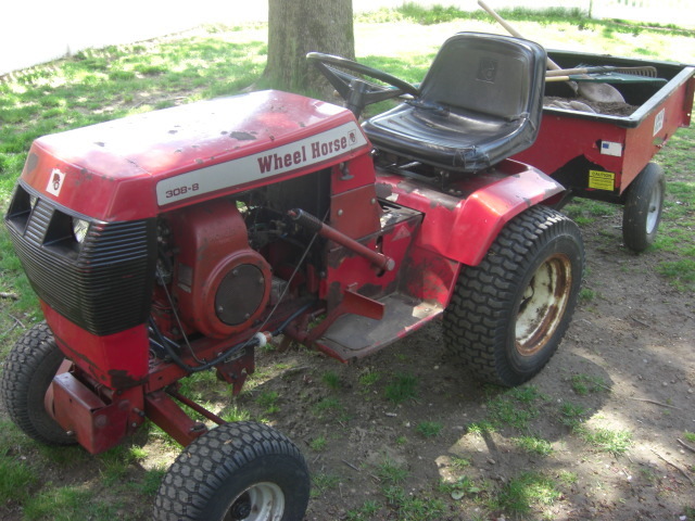

Retired Wrencher 7,046 #1 Posted May 12, 2016 (edited) Hi I have an older 8hp That was neglected that is in an newer 308-8..It smokes real bad when cold not to bad when hot I have changed the oil 3 times now less than a week. The oil that was in there when I pick it up was like black sludge. Could not tell because of below the markings on dip stick when I bought for cheap. So this last oil change I tried some of that no smoke oil in a bottle with regular 30 weight. I am thinking that the oil ring is gum up casing blow by. I am also thinking of using a motor flush. Like a Gunk 5 minute product . Has any one ever tried this in a small engine? I do not mind some smoke but this one is a little bad. Edited May 12, 2016 by T1257 RETIRED WRENCHER. 1 Share this post Link to post Share on other sites
