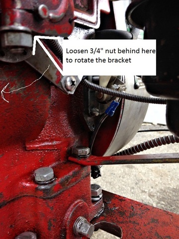

wallfish 20,049 #26 Posted May 15, 2016 Can you please post some pics of your engine on the tractor? Especially the front of the engine with the wires. Something is just not right since that screw should have nothing to do with anything except holding the throttle control. Is that a black wire coming through that little hole in bottom left of that pic? Share this post Link to post Share on other sites
squonk 46,862 #27 Posted May 15, 2016 It sounds like the mag coil is not insulated from the block and grounding thru that throttle cable. That coil may be bad were the windings are leaking thru to where it mounts to the engine. Share this post Link to post Share on other sites
wallfish 20,049 #29 Posted May 15, 2016 If the throttle conduit contacts the points, that would do it. Do you have the points cover? 1 Share this post Link to post Share on other sites

jsp_333 291 #31 Posted May 15, 2016 Wallfish: Nailed it!! I took the engine out of the tractor fired it up and then positioned the throttle conduit to touch the points. Engine immediately started to fail. Took it away and repeated the process. Same result. So I'll get the points cover back on once I'm happy with the engine timing. 1 Share this post Link to post Share on other sites

wallfish 20,049 #33 Posted May 15, 2016 If needed you can change the position of that conduit so it doesn't interfere or have to be bent. There is a 3/4" nut behind the governor arm which holds that bracket. Just loosen that nut a little and you can re-position that bracket. The conduit can go under the pulley side of the engine 2 Share this post Link to post Share on other sites
