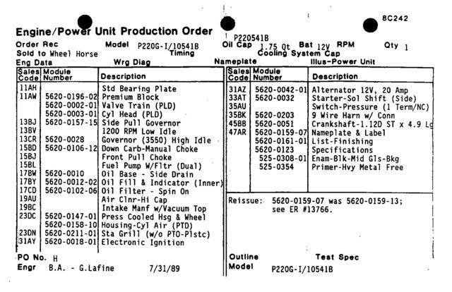

onanparts.com 185 #12 Posted May 18, 2016 According to an older post here, the Onan P220G-I/10541B was one of two Onan P220G engines used on the 520-HC. Here is the Onan unit Production Order for the 10541B spec. Share this post Link to post Share on other sites
