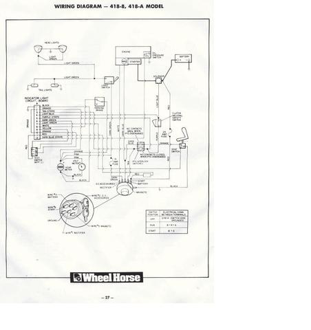

19richie66 17,797 #5 Posted May 10, 2016 (edited) The two small terminals on the solenoid. One should be grounded and the other should get power with the key turned to start. This activates the starter. The power goes away when you release the ignition switch back to run. here is the schematic for the 418 A and 418-8. I didnt see a 418-c. There are several safety switches between the keyswitch and solenoid. I have a 418-a and I rewired mine due to all the switches being trashed and bypassed before I got it. Good luck with it. should be able to run a temporary jumper from the "tan" wire from starter on ignition switch to "light blue" on solenoid. It should bypass all the switches for testing only. In no way am I telling you to disable your safety switches. Edited May 10, 2016 by 19richie66 1 Share this post Link to post Share on other sites

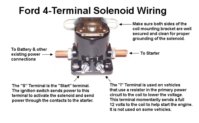

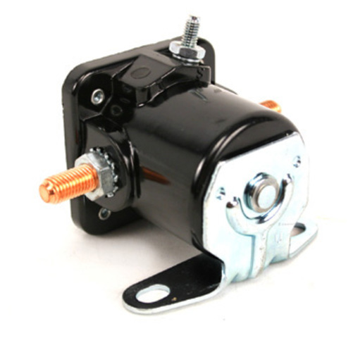

Racinbob 12,706 #6 Posted May 10, 2016 Richie, I'm thinking he may have replaced the solenoid with a Ford style. Richard, is that the case? If so, the small 'I' terminal doesn't get used in this application. 1 Share this post Link to post Share on other sites

Racinbob 12,706 #8 Posted May 10, 2016 He may have . This is one of the many reasons I don't like troubleshooting electrical stuff via forum posts. 1 Share this post Link to post Share on other sites

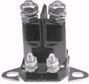

Racinbob 12,706 #10 Posted May 10, 2016 (edited) I'm a bit confused here. Is yours like this? The positive battery cable connects to one large terminal, a cable connects to the other large terminal and goes to the starter, providing it hasn't been changed a light blue wire connects to the small terminal and it is grounded through the mounting bracket. The only time the small terminal will have power is when the ignition switch is in the momentary 'start' position. Temporarily install a jumper from the switch to the small terminal like Richie mentioned. If she cranks then you have a safety switch issue or a broken or disconnected wire. With a test light or meter take it one step at a time starting at the start terminal on the switch. Then go to the PTO switch, then to the clutch neutral safety switch and finally to the small solenoid terminal. One more thing. Is your motor mounted on a shaker mount? If it is, there's a grounding jumper from the motor to the frame. Make sure it's good and clean. Edited May 10, 2016 by Racinbob 1 Share this post Link to post Share on other sites
