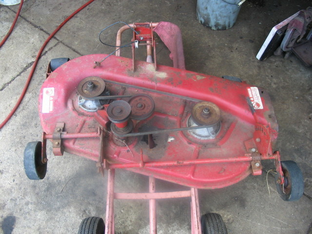

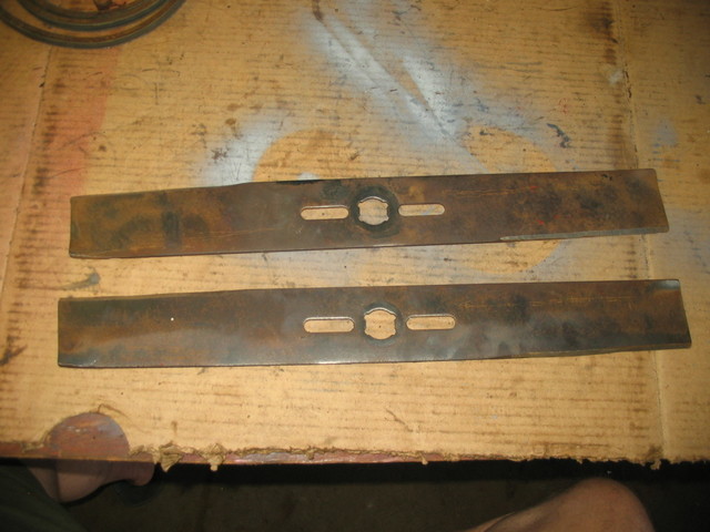

daveoman1966 3,883 #3 Posted May 10, 2016 (edited) I have a good used set of blades for the 37" side disch deck.... Ebay item # 131575962161. Here is a pic of the deck I took the bladeds from Edited May 10, 2016 by daveoman1966 1 Share this post Link to post Share on other sites
WHX?? 56,763 #4 Posted May 10, 2016 Is that hole in the deck for inspecting the blades from the topside Dave? Share this post Link to post Share on other sites

lynnmor 8,834 #6 Posted May 10, 2016 44 minutes ago, WHX61/3 said: Is that hole in the deck for inspecting the blades from the topside Dave? That might be one of those washout holes where you squirt water in from a hose. Prevents rust! 1 Share this post Link to post Share on other sites

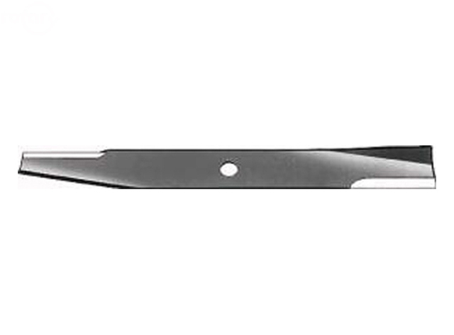

WHX?? 56,763 #8 Posted May 10, 2016 It does look like Toro is quite proud of those blades/kits. Time to go looking aftermarket my friend. TORO BLADE 18-3/4"X 3/4" REPLACES TORO 109918 Replaces: OREGON 91-817 PRIME LINE 7-04724 STENS 350-157 SUNBELT B1SB3468 TORO/WHEEL HORSE 10-9918 WINDSOR 50-2425 I guess for the price difference I wouldn't be afraid to try a pair, or any 18.75 high lift blade with the appropriate size mounting hole. I run these blades in my wife's 38" cut bagger with no problems. Keep the deck, discharge & chute clean you shoudn't either. Share this post Link to post Share on other sites

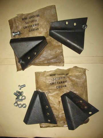

daveoman1966 3,883 #18 Posted May 13, 2016 I just discovered a set of HIGH LIFT BLADE TIPS as Wheelhorse Part # 110974. I put them on Ebay and the item # is 131812640379. Would these be the blade adapters to suit your needs? Share this post Link to post Share on other sites
lou thomas 2 #19 Posted May 13, 2016 Thanks Dave, but the blades are split, I need all new stuff. I contacted Killians on line but haven't gotten a reply yet, Share this post Link to post Share on other sites
