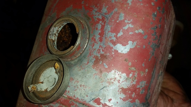

prondzy 3,889 #1 Posted May 10, 2016 Has anyone found a good replacement cap for this style tank found on 65-69 WH? Or replacement gasket? Share this post Link to post Share on other sites
JPWH 6,544 #2 Posted May 10, 2016 (edited) Flea bay vented motorcycle chrome cap. About 10.00. That's what I got for my 854. Edited May 10, 2016 by JPWH 2 Share this post Link to post Share on other sites
AMC RULES 37,256 #3 Posted May 10, 2016 Thought I read the Harley caps look, and fit perfectly. 2 Share this post Link to post Share on other sites
squonk 46,080 #4 Posted May 10, 2016 If your local Napa still has it's gas cap catalog, You can bring in the old one and it can get measured up. The book has cap sizes in it. 2 Share this post Link to post Share on other sites

prondzy 3,889 #7 Posted May 10, 2016 This is not for a round hood tractor, this is for an 855 up to a 1277 a different cap. Share this post Link to post Share on other sites
