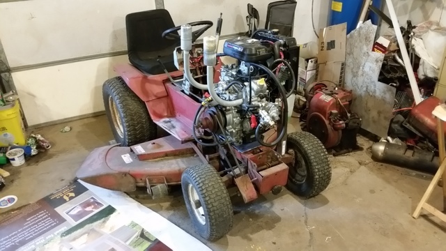

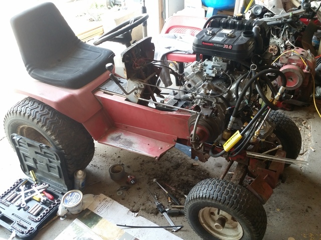

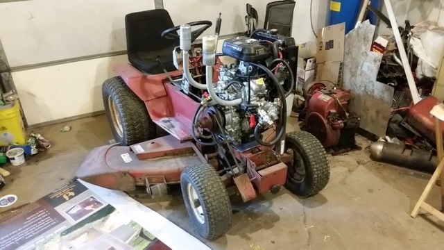

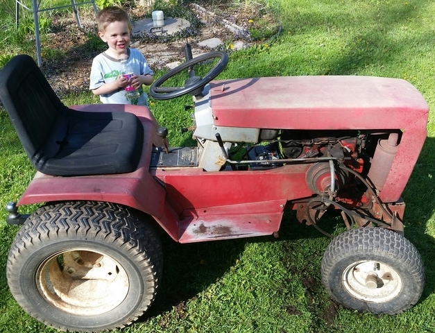

onesweetcaprice 34 #1 Posted May 9, 2016 Growing up my neighbor was a wheel horse dealer, he was a great guy and a very close friend. He passed away about 10 years ago now and unfortunately his wheel horse collection all got sold before I ever got a chance to get 1 of them to hang on to in his memory. Well after years of searching I stumbled across a 66' 1276(?) That was purchased from old Jack Miller in his dealership days. Needless to say I got in the truck and it's now in my garage. The orginal 12hp Kohler had long since given itself a "rod-ectomy" and was no longer around, so a 10hp kohler was on it when I picked it up. The "new" motor ran REALLY well, but burned more oil than fuel (it was seriously impressive how quickly it would drink a quart). So after talking to some friends and family about my new found project I was given an outstanding deal on a kawasaki 20hp twin, liquid cooled motor with 4 hours on it (FD620D, currently set up to run propane). A few hugs, handshakes, and $150 later the transplant began. NOT A SINGLE HOLE has been added to the wheel horse, I will keep it as unmolested as possible incase I ever decide to do a full restoration, (although old Jack was a hot rod man so he'd probably appriciate the engine swap) but this is now leading me to a slight issue. The monster V-Twin is a we bit bigger than the kohler, and I can not bring myself to cut up the hood/grill, it's in really good shape. Anyone have a spare? Are there any hoods that are less rare that I would be better off "destroying"? -tried to upload a couple pictures, keep getting an "upload failed" pop-up There we go. 7 Share this post Link to post Share on other sites

onesweetcaprice 34 #4 Posted May 9, 2016 Thanks! As far as the propane goes, I havnt the slightest idea if i should keep it that way.... it could be easily converted back to gas. The propane "kit" is pretty simple, besides the regulators and safety valve that shuts the gas off it the motor dies, it's just a 1" tall "ring" that is added on top of the carb. Gas would be easier, but with propane I'd never have to clean the carb, or winterize, or worry about fouling plugs.... 1 Share this post Link to post Share on other sites

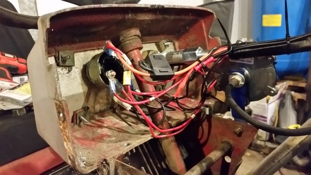

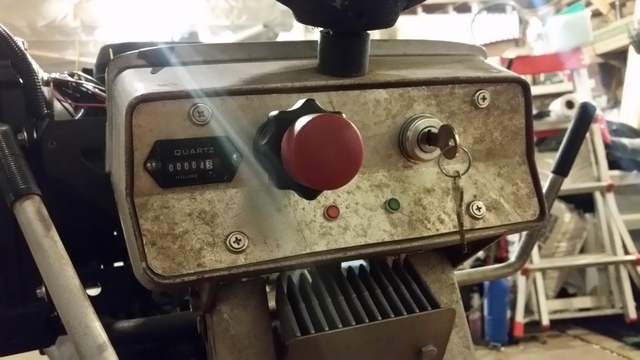

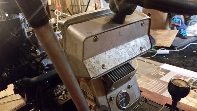

onesweetcaprice 34 #10 Posted May 9, 2016 21 minutes ago, oliver2-44 said: I know where there a WH1972 10 or 12 hp model 103658 serial 981958. "no- name" parts tractor that I'm trying to get for the Kohler Engine on it. It has already had some parting out, and the hood has already been cut a little. Can someone here identify if it would fit? If it does I can get pic's and we continue this discussion on private messages. If you could send me some pictures that would be great. I do a lot of custom fab work, so even if the hood is some-what close I can make it work. Here's a few more pictures of last night's little project, I didn't want to hack up the stock "dash" to mount the extra controls for the kawasaki, so I made a new one. FYI X-Ray film makes AWSOME templates for custom stuff. And apparently Im not allowed to upload the finished product pictures.... how do you upload more than 8.21mb's of pictures? 4 Share this post Link to post Share on other sites

onesweetcaprice 34 #18 Posted May 11, 2016 (edited) That's ok, I took some measurements last night after working on the wire harness for awhile (16 wires coming out of the engine harness is to damn many for a lawnmower lol). If the local John deere dealer doesn't have any old mufflers laying around I'm going to start on making one tonight. Now to decide what is the most "fitting" for this swap, duel stacks, duel stacks with a crossover, or a regular Ole muffler.... Edited May 11, 2016 by onesweetcaprice 1 Share this post Link to post Share on other sites

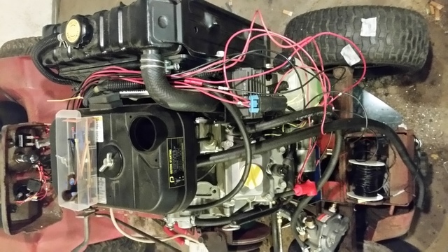

onesweetcaprice 34 #19 Posted May 12, 2016 Just the wiring for the engine harness.... havnt even tapped into it for the safety switches yet.... to damn many wires for a lawnmower engine! 1 Share this post Link to post Share on other sites

onesweetcaprice 34 #21 Posted May 15, 2016 Doesn't seem like there are to many interested in this...... but for those that are.... got it far enough done to test it out today. Runs great, 48" deck in tall grass and there was ZERO engine bog when engaging the deck. Runs beautiful, drives awsome, cuts better than ANY other mower I have ever owned.... I'm in love, and it's not even done yet... 5 Share this post Link to post Share on other sites
