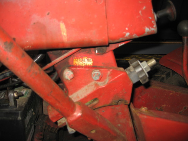

psalms83:18 174 #4 Posted May 8, 2016 your right....sometimes the smallest push helps the most. it does look like a 1045ish but where would the serial numbers be so I would know what model or style or year... If on the engine how do I know if that engines original? Share this post Link to post Share on other sites

Shynon 7,656 #6 Posted May 8, 2016 30 minutes ago, psalms83:18 said: but where would the serial numbers be 1 Share this post Link to post Share on other sites

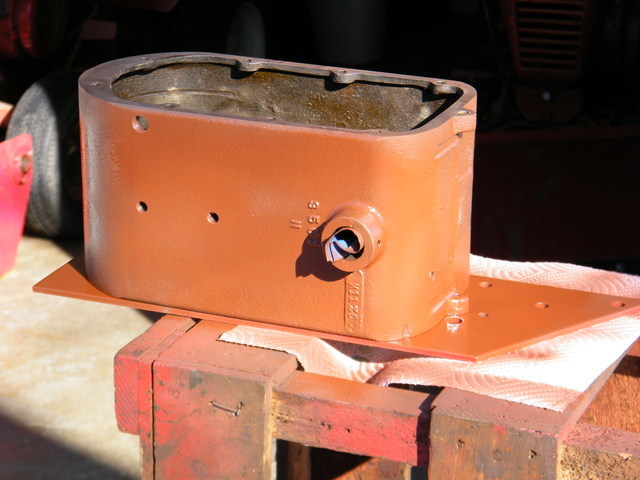

stevasaurus 23,834 #10 Posted May 8, 2016 On the transmission, you are not going to be able to tell the difference between a #5025 and a #5049 without opening up the trans...they are basically the same transmission. The only numbers you will find on the trans is the casting number (tells what day and year it was cast) and maybe the part number for each side. Neither one will help you figure out what you have. I think the steering wheel is going to be the key here. What engine is on there, and what are the numbers?? Share this post Link to post Share on other sites

psalms83:18 174 #12 Posted May 8, 2016 12 minutes ago, stevasaurus said: On the transmission, you are not going to be able to tell the difference between a #5025 and a #5049 without opening up the trans...they are basically the same transmission. The only numbers you will find on the trans is the casting number (tells what day and year it was cast) and maybe the part number for each side. Neither one will help you figure out what you have. I think the steering wheel is going to be the key here. What engine is on there, and what are the numbers?? I put a pic of the engines serial above... I read somewhere this guy has a compilation of serial numbers from a number ""near the shifter"" that can tell the year it was made batch etc... He was very knowledgeable but on a different site Share this post Link to post Share on other sites
stevasaurus 23,834 #13 Posted May 8, 2016 That #2274 on the quadrant is the WH part number. The engine numbers help a little. the #46219A is the spec number for the K241AS Kohler that was only used in the 1045, 1055 and 1075 horses. It is starting to look like a 1045. This manual for the 1045 from 1964 tells how to adjust your belt guard to stop the grinding. Here is the link. For the number on your casting... This one has a tag "K11%0. It works like this...K is the month (and you skip the letter "I"...because it looks like a 1). So "K" = 10th month...October. 11 is the day of that month. The 0 is 1960. So K11%0 = October 11, 1960. I think that the only thing you could draw from this is...this case did not come with a 1958/9 RJ, but it could have come on a 1961 Suburban. 4 Share this post Link to post Share on other sites
psalms83:18 174 #14 Posted May 8, 2016 so not having cleaned up this tranny tag yet..would u think its a D8%5....april 8 1965?? and thanks all for the link for the belt...LOL my dad has been posting a few things and questions on facebook and not getting half as good replies and info. Muhaha 1 Share this post Link to post Share on other sites

stevasaurus 23,834 #16 Posted May 8, 2016 Yep, April 8, 1965 So it is probably not a 1964 Wheel Horse 1045. Gotta be a 1965 Wheel Horse 1045. On the other hand, the way Wheel Horse did things back then, it could very well be a 1964 Wheel Horse 1045 put together in 1965. Share this post Link to post Share on other sites
