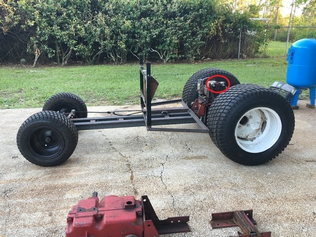

19richie66 17,937 #1 Posted May 7, 2016 So I have a Sundstrand hydrostat from a C175 I put in my cruiser. It had the hydraulic deck/ lift cylinder/ valve assy also. If I desired to put power steering on this thing, could I use the lift cylinder for a steer cylinder? I have a 5 port rotary steer valve and was wondering if I could plumb it to the ports where the hoses came out of the pump? (where the red circle is)? I have searched but only found info on the Eaton and it was vague. Thanks in advance, Richie 2 Share this post Link to post Share on other sites
953 nut 70,057 #2 Posted May 7, 2016 Can't see why it couldn't be done, just as good as any other two way cylinder. You may have to experiment with Pittman arm length and play with bypass pressure to make sure it is a smooth movement. 1 Share this post Link to post Share on other sites

953 nut 70,057 #4 Posted May 7, 2016 11 hours ago, 19richie66 said: 5 port rotary steer valve What did the valve come from? If pressures are the same as the Sundstrand it should be fine. Share this post Link to post Share on other sites
19richie66 17,937 #5 Posted May 7, 2016 It's still on my JD gt345. I don't think it will make it through another mowing season. If not, the power steering is going on my cruiser or the 418-A. Just was wondering about the sundstrand. Manual says 500-700 psi for the pump and the rotary valve is good for 1500-1800 psi. I think it would work. Found the port layout on both. Just a matter of mounting all the parts. Share this post Link to post Share on other sites
