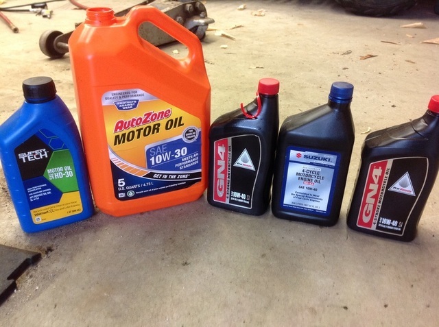

Sparky-(Admin) 26,899 #1 Posted May 6, 2016 I'm sure like me, many of you have oil bottles with just a bit left that you can't toss out. So is there any harm in mixing differant brands or weights of oil? Mike.... 3 Share this post Link to post Share on other sites

Sparky-(Admin) 26,899 #4 Posted May 7, 2016 Ok...good...that's two in favor of mixing. I say that because I already mixed it all for an oil change in my 310-8 (Magnum). After draining the oil I discovered that all my straight 30w was gone, so those bottles in my pic all went in the 310. Mike..... 1 Share this post Link to post Share on other sites
