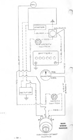

rmaynard 14,932 #4 Posted May 6, 2016 Yes, all low amperage 12 volts goes through the ammeter. See diagram below: And be sure that the ignition switch that you got is for battery ignition and not magneto. Magneto will have and M lug on the back. Looking at the wiring diagram, the ignition does not go through any safety switch. 2 Share this post Link to post Share on other sites

TDF5G 2,051 #6 Posted May 6, 2016 1 hour ago, rmaynard said: Yes, all low amperage 12 volts goes through the ammeter. See diagram below: And be sure that the ignition switch that you got is for battery ignition and not magneto. Magneto will have and M lug on the back. Looking at the wiring diagram, the ignition does not go through any safety switch. Make sure the ignition switch is wired correctly. Share this post Link to post Share on other sites
Jp southwick 1 #7 Posted May 6, 2016 my safety switch at the PTO is wired different than this diagram. everything seems to be wired thru it, the clutch safety, seat safety, ignition etc? Share this post Link to post Share on other sites
gwest_ca-(File Mod) 10,524 #8 Posted May 6, 2016 What is the model and serial number on the tractor ID plate? Perhaps yours is wired like this one Garry Share this post Link to post Share on other sites
Jp southwick 1 #9 Posted May 9, 2016 that worked, the ignition was mis wired, thank you 1 Share this post Link to post Share on other sites
