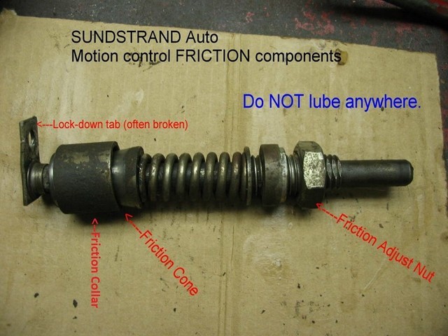

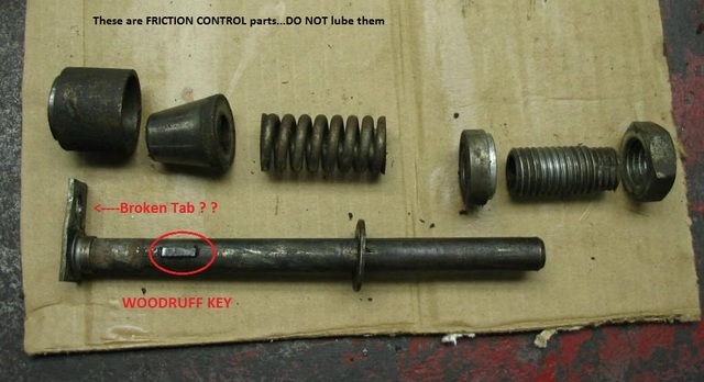

daveoman1966 3,884 #4 Posted May 5, 2016 Here is the Sundstrand version. Do NOT lube this when assembled. 12 Share this post Link to post Share on other sites

Chuck14025 9 #6 Posted June 14, 2017 What happens if the parts are lubricated? Is there a way to clean the parts? Share this post Link to post Share on other sites
EricF 589 #7 Posted June 14, 2017 Lubricant, particularly in the cone assembly will probably attract and hold dirt, which will make the mechanism prone to grabbing/rough operation. Some blue Loctite on the friction adjusting nut might be appropriate to keep it in position, but that's probably all. Share this post Link to post Share on other sites
daveoman1966 3,884 #8 Posted June 15, 2017 Don't lube these parts at all. They are designed to work on 'friction' and to apply a lube defeats the entire purpose as any lube is a friction reducer. Just keep the parts clean as possible....that's why there is a cover over them. As EricF noted, the lube is also a dirt magnet, leading to premature failure and/or erratic operation. Share this post Link to post Share on other sites

daveoman1966 3,884 #12 Posted June 16, 2017 (edited) IMHO... Just clean with your choice of solvent...brake cleaner is fine. DO NOT USE any sort of lubricant...especially on the cone assembly. Lubricant defeats the purpose of the FRICTION characteristics of the motion control function. Leave it dry. Any sort of lube is a dirt magnet, which you don't need. Edited June 16, 2017 by daveoman1966 Share this post Link to post Share on other sites

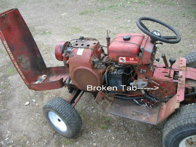

daveoman1966 3,884 #15 Posted June 16, 2017 MAYBE.... look at the LOCK DOWN TAB of the motion control apparatus. If it is broken where it gets bolted to the outside of the hoodstand, that would cause erratic behavior. Here is a C-160 pic and the tab location is noted. Your tractor should be similart to this. Share this post Link to post Share on other sites

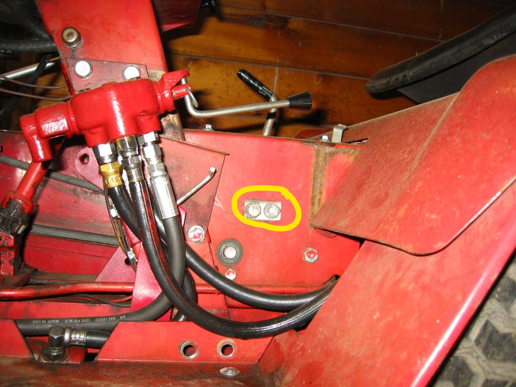

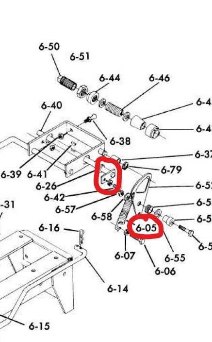

pfrederi 21,274 #17 Posted June 20, 2017 (edited) 1 hour ago, Chuck14025 said: Thanks for the suggestions. My C120 is an Automatic and does not appear to have a 'lock down' tab. Holding the brake pedal back does not improve the ERRATIC OPERATION of the system. It is 'jumping' into and out of forward and reverse in other words, very rough automatic shifting. Could it be: 1. Low on hydraulic oil? 2. Something to do with the 'Neutral Adjustment' ? If you do not have a lock tab at the end of the shaft going across (circled in red) you have a problem. The tab is on the outside of the hoodstand circled in yellow in the picture the weld that can break is to the right of the bolt. I assume the spring you are missing is the number i circled 6-05. either fault is going to cause issues. A neutral adjustment is also a good idea. Edited June 20, 2017 by pfrederi Share this post Link to post Share on other sites

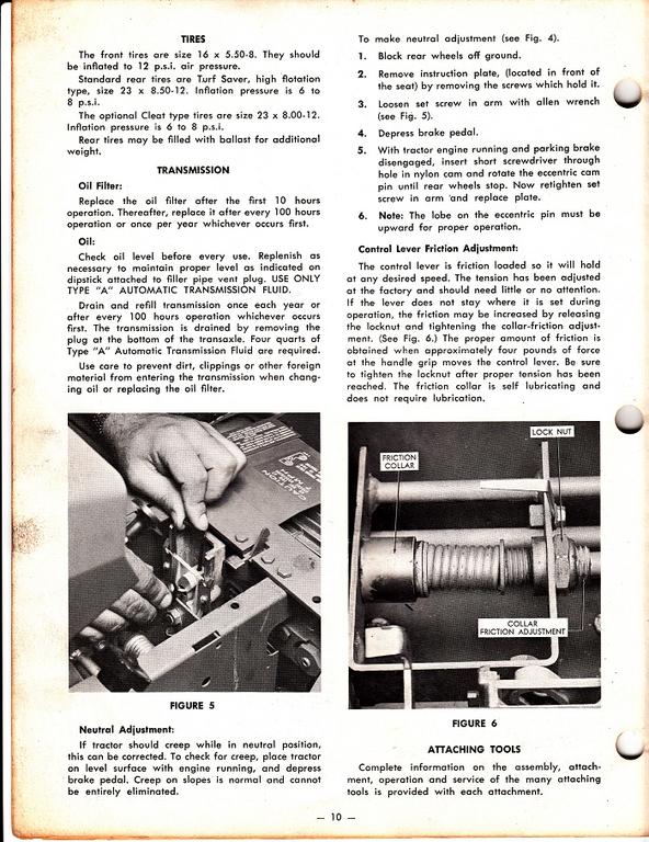

Chuck14025 9 #19 Posted July 28, 2018 Any thoughts on adjusting the friction collar when it is put back in would be helpful. Share this post Link to post Share on other sites

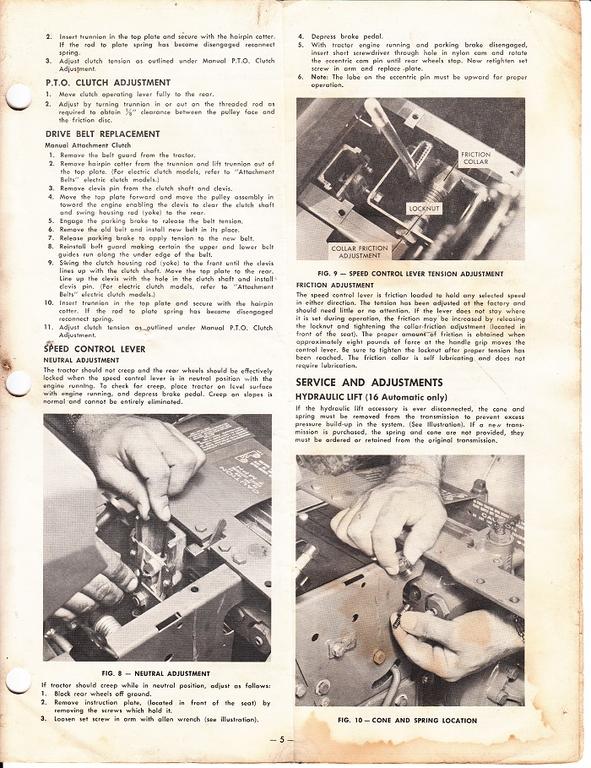

Sarge 3,473 #20 Posted July 29, 2018 Friction collar adjustment is found in the manual for your tractor - follow those instructions closely and it will work like it should. The return spring, I believe is still available from Toro. Sarge Share this post Link to post Share on other sites

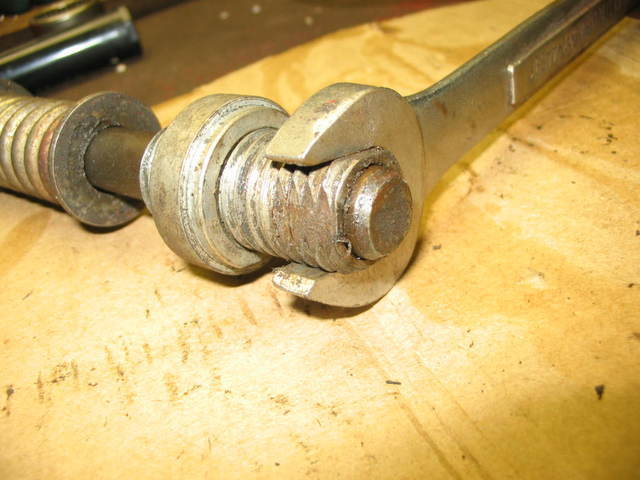

daveoman1966 3,884 #21 Posted July 29, 2018 Here is the adjustment method... Share this post Link to post Share on other sites
birt 0 #22 Posted August 16, 2018 I have a C120 with the lock tab busted off the shaft. I cleaned it up and see now that if the shaft were attached on the left hand side I'd be safe again. It appears to me that the shaft in the breakout diagram there as 6-40 should include the lock tab. Do you know if I'm correct that this is Toro 741211 TIRE WHEEL AY [ ex. https://www.jackssmallengines.com/jacks-parts-lookup/part/toro/741211 ] I can source that part. Further, any tips on removing that shaft if it's the correct one? It's somehow attached on the right hand side and I didn't pull that panel to look how bad. Share this post Link to post Share on other sites
pfrederi 21,274 #23 Posted August 16, 2018 The old part Number was 7604. That is a ridiculous price for a new one. If you have teh old tab you could weld it on. Would not be a big project to make a tab to weld on. or go to A-Z tractor a vendor here for a used one....http://a-ztractor.com/ 2 Share this post Link to post Share on other sites
birt 0 #24 Posted August 24, 2018 Thanks for the tip on A-Z they are great and I got a new shaft. How do you get the shaft out, including the woodruff key in it? I'm considering to just cut it in the middle since I have a 2nd one now.... Does that friction collar have a slot that fits on to the woodruff key? I tried to pull it out the direction of the tab side but it was pretty set. Did you compress the spring to get at the key and remove it? Share this post Link to post Share on other sites
