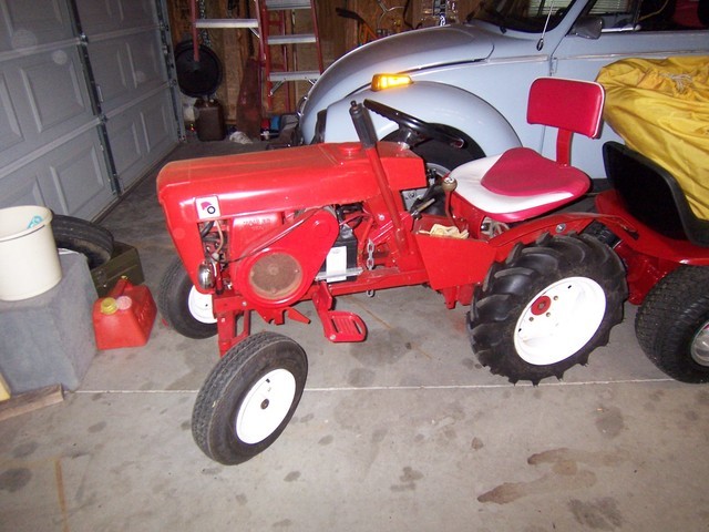

jb4249 143 #1 Posted May 5, 2016 I have a nicely restored RJ 58 that I have been working on for a couple of years and finally got it together this spring. I have a K90 for it that jut refuses to run. I did a project over the winter and put a Predator engine from Harbor Freight on a Lawn Ranger, and it worked out pretty well. So I picked up the small 79cc engine and put it on my RJ58. It fit perfectly and runs and the tractor drives nicely. I want my grand kids to be able to use this, as well as my other WH's so I wanted the put the belt guard on. I had a repro that I bought on the internet and found that it fit perfectly. Bolts to the engine and the transmission side plate as designed. No big deal I guess, I just wanted to pass it along. Thanks, ted jb4249 12 Share this post Link to post Share on other sites

jb4249 143 #7 Posted May 5, 2016 The Engine was $89 at Harbor Freight. It is the 79cc model about 3 hp. I put the 212 cc on my Lawn Ranger. I couldn't find any good pics of the RJ, so I will take a few this afternoon and post them. Ted 3 Share this post Link to post Share on other sites

jb4249 143 #9 Posted May 5, 2016 As promised. The Lawn Ranger is in the middle and my 854 is closest to the door. Also pictured is the K90 engine that I intended on using on the RJ, still might if I can get it to run. 7 Share this post Link to post Share on other sites
