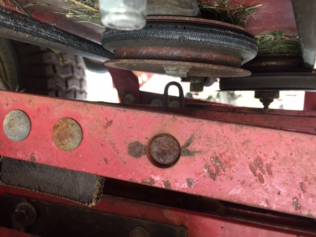

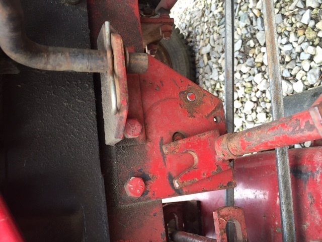

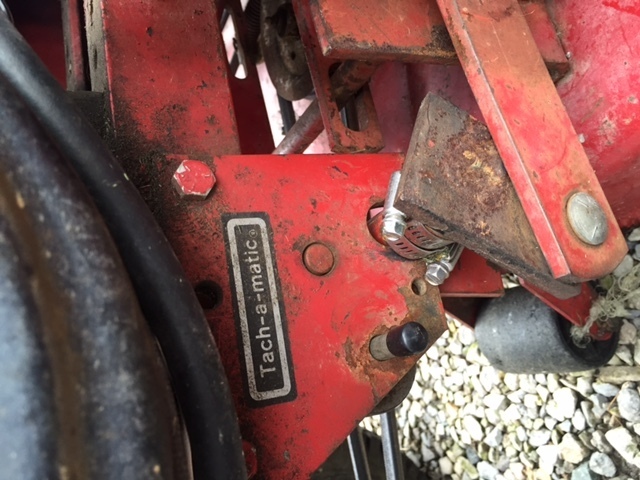

TimH 105 #8 Posted May 5, 2016 Here a few picks of some problems mounting deck I think. Doesn't raise with handle. I think there needs to be a bracket and chain is not hooked up. Thanks Share this post Link to post Share on other sites
elcamino/wheelhorse 9,363 #9 Posted May 5, 2016 I am no expert but I have a few questions and hopefully some answers. Why are the hose clamps attached to the rod in picture 2? Does the deck stick out one side of the tractor than the other? If so the bracket in picture 1 should be on the other side of the attach o matic bracket. Share this post Link to post Share on other sites
TimH 105 #10 Posted May 5, 2016 2 hours ago, elcamino/wheelhorse said: I am no expert but I have a few questions and hopefully some answers. Why are the hose clamps attached to the rod in picture 2? Does the deck stick out one side of the tractor than the other? If so the bracket in picture 1 should be on the other side of the attach o matic bracket. Old owner must of broke bracket A home made one was welded on Looks like he used hose clamps as spacers . I see what you mean about deck it is off center. I still can not figure out how the mower deck gets raise. Does the chain do that if its hooked up ? Thanks Share this post Link to post Share on other sites
gwest_ca-(File Mod) 12,522 #11 Posted May 5, 2016 Here are the manuals for a deck that fits your tractor. May not be the same style or size of deck but they all hook up the same. Garry Share this post Link to post Share on other sites
elcamino/wheelhorse 9,363 #12 Posted May 5, 2016 (edited) I hope I get this right. If you lower the deck all the way to the ground and lower the rear wheels on the deck , the deck should be 1/2 inch to 3/4 inch off the ground. Lower the lift ( I assume yours is hydraulic) to the down position. A arm with a pin should be visible. There should be a bar on the deck with a slot in it. Slide the deck so the pin goes into the slot. There should be a rod hanging down from the lift arm that attaches to the chain. Rotate the rod with the hose clamps so the v shaped bracket will engage the rod on the attach a matic hitch. raise the hydraulic lift to the up position and your deck should raise off the ground. It is hard to explain but has the easiest deck attachments I have ever seen. Ok guys help me out with my 1/2 A _ _ explanation. Look at the manual closely it should explain everything. Edited May 5, 2016 by elcamino/wheelhorse added to Share this post Link to post Share on other sites
