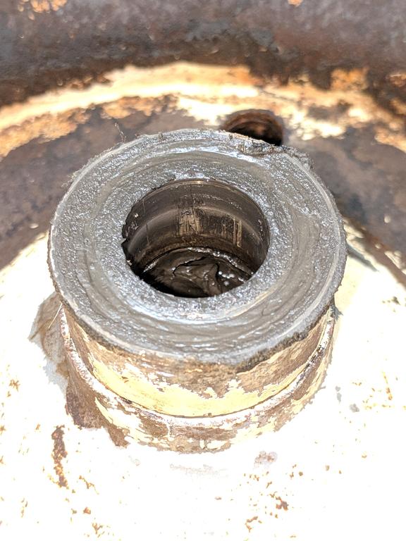

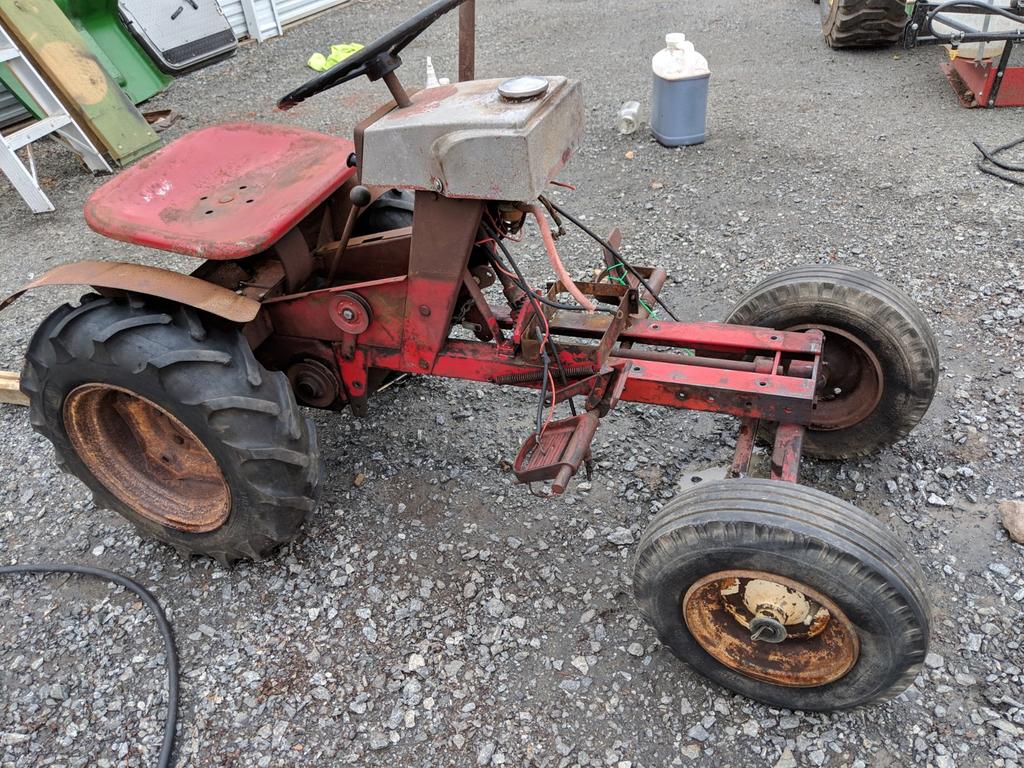

dapetik 9 #6 Posted April 5, 2019 On 5/3/2016 at 4:12 PM, RedRanger said: If you're replacing bushings, you could put wheel bearings in for much less money. http://www.ebay.com/itm/4-WHEEL-BEARINGS-TORO-WHEEL-HORSE-11-0513-25-1210-110513-and-251-3-4-x-1-3-8-/281473149545?hash=item41891b6a69:g:3akAAOSwxH1UCkt1 Can you elaborate on this? I need to rebuild my front wheels Share this post Link to post Share on other sites
WHX?? 57,824 #7 Posted April 5, 2019 (edited) Some of the fronts had bushings instead of the low speed bearings. Mostly on the early 60's tractors, but you never know where you will find them. If your rims have an ID of 1 3/8" you can pop out the bushing and install the bearings Red mentioned above. Measure carefully some rims with bushings had a slightly larger ID and bearings will be a sloppy fit. . Your rims should have grease zerks in them for both styles. Check your spindles for wear if you had the bushings installed. Be careful of buying the bearings Red listed above. You will find loads of on Fleabay and elsewhere but some are junk and some are fairly decent. If Red says he got some of the ones he listed are the decent ones that's good enough for me. Keep in mind these are coined low precision bearings and for low speed only. You can get them in precision high speed too if you want to go the extra cost. You will also see them listed as being sealed but if you are using them on a worker pop the inner seal out before installing and keep them greased. Trailer queen it won't matter. Edited April 5, 2019 by WHX22 1 Share this post Link to post Share on other sites
dapetik 9 #8 Posted April 6, 2019 (edited) 21 hours ago, WHX22 said: Some of the fronts had bushings instead of the low speed bearings. Mostly on the early 60's tractors, but you never know where you will find them. If your rims have an ID of 1 3/8" you can pop out the bushing and install the bearings Red mentioned above. Thank you for your reply. Looks like I have bushings. No time today to try to pop them out. Edited April 6, 2019 by dapetik 1 Share this post Link to post Share on other sites
