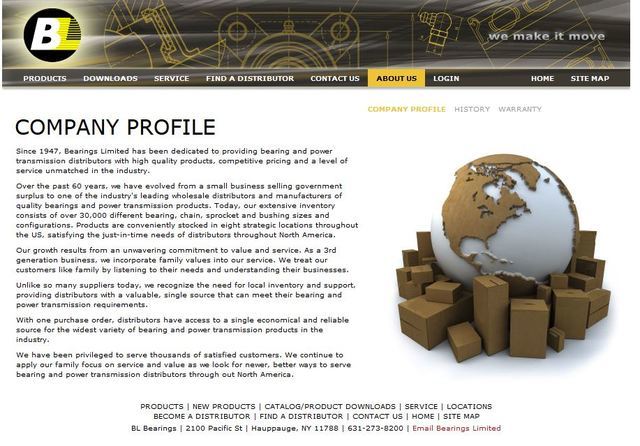

Factory Dog 44 #5 Posted May 8, 2016 I stopped in at the Toro dealer this morning and ordered the clutch facing, thanks again for your help. I ordered the bearing through my local Fastenal Dealer for $9.00. The manufacture name given for the bearing was Bearings Limited. The clerk said that this was the Fastenal brand name, and that someone else actually manufactures the bearing. I figured I will not be out much if it does turn out to be junk. Has anyone had any experience with bearings under this name? I was also wondering if anyone knows what type of surface finish I should put on the pulley clutch surfaces, polished vs. more of a brushed finish? Share this post Link to post Share on other sites
pfrederi 20,688 #6 Posted May 8, 2016 I would go with a brushed finish. Bearing Limited seem to be a supplier that may have bearings made for them Can't comment on quality but never heard anything bad. They distribute through Fastnal but also many other outfits. Share this post Link to post Share on other sites
Factory Dog 44 #7 Posted May 8, 2016 Thanks! It is becoming very difficult to figure out who makes what anymore. Share this post Link to post Share on other sites
