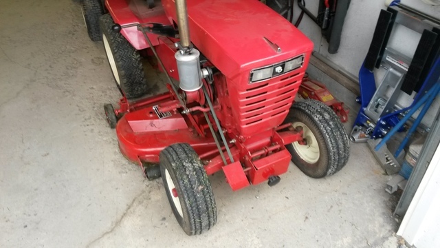

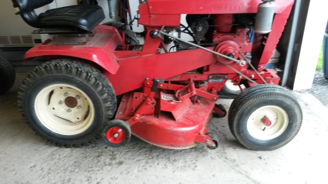

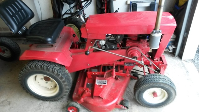

squonk 46,904 #1 Posted May 1, 2016 I've been wanting to do this for a while. Skonk (1267) is my favorite puttin around tractor and I have all ready installed frt. and mid Tach-O-Matics. So now after fixing an oil breather leak, it's time to install the more plentiful std. deck. Just had to figure out how to lift it as the 1267 doesn't have the lift bar nor holes in the frame to install one. Used a chain and trunion from the rock shaft and drilled a hole in the deck bar to attach the chain. I do need to add a link or two. 13 Share this post Link to post Share on other sites

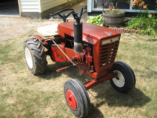

squonk 46,904 #5 Posted May 1, 2016 This tractor is/was loud. It's a Gravely muffler with an extra baffle welded into the stack. Seat is a std. issue TSC seat Share this post Link to post Share on other sites
russellmc301 601 #6 Posted May 1, 2016 so is it loud with the gravely muffler? Share this post Link to post Share on other sites
squonk 46,904 #7 Posted May 1, 2016 This motor is louder than anything I ever had for some reason. It started out with a pepper pot on it that rattled the windows. I got this Gravely muffler but it's made much cheaper than one I got previous for my Power King. The extra baffle in the stack helps a lot. I tried one of Bud Andrews mufflers. They look great but was too loud for running after dinner mowing the lawn. I don't know why this K301 is so loud. The K321 on the PK sounds great with the Gravely unit. Share this post Link to post Share on other sites
Shynon 7,596 #8 Posted May 2, 2016 I have been using these cub cadet style mufflers, I think they are not to loud, just have to cut off the mounting tab welded to the side. I am wondering how many tree's you will run into sitting on that seat. ZZZZZZZZZZZZZZZZZZZZ 3 Share this post Link to post Share on other sites
