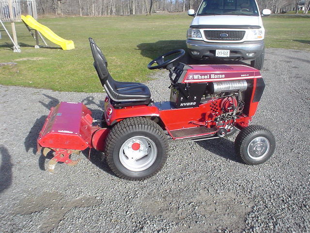

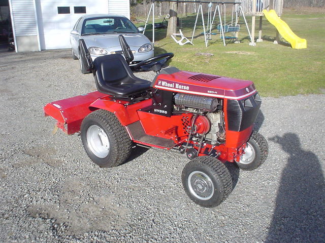

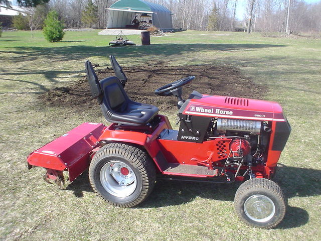

cleat 9,384 #2 Posted May 1, 2016 I tilled with your kit last year with one of my 520's. Worked great. 2 Share this post Link to post Share on other sites

cleat 9,384 #4 Posted May 1, 2016 They are. I don't know if they make a real difference but it makes me feel better. 2 Share this post Link to post Share on other sites

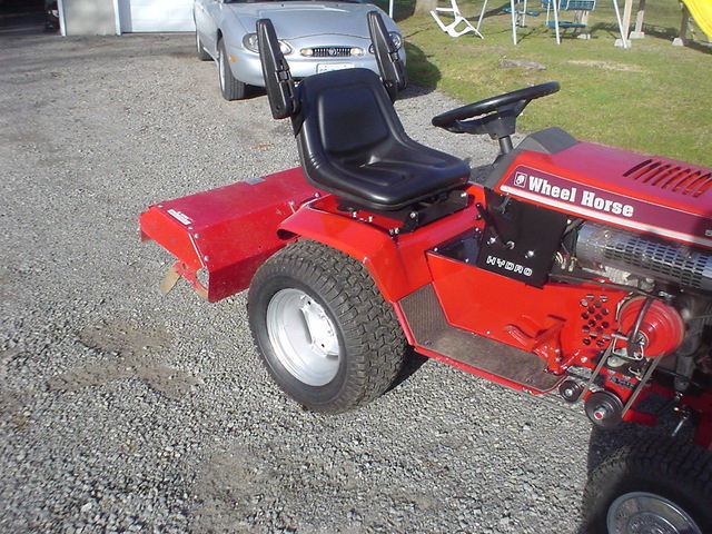

bmsgaffer 2,071 #6 Posted May 6, 2016 I had to adjust a few spacers on the tiller idler pulleys (i think I had to put more on behind the pulleys to space it out more, it was a while ago) to get it to fit past the pedal but it actually lined up the idler pulleys better with the PTO pulley so I couldn't complain. Two things I have had issues with are the snowblade angle arm (but I have a fix planned i think) and then any mower deck that has the three-bar leveler that came with the vacuum bagger system, you cant raise the deck or the under-pedal "ear" hits that third bar. I dont have a bagger though, so I just need to get a new "two-bar" leveler for the deck. Share this post Link to post Share on other sites

ba2988 28 #8 Posted May 7, 2016 I have Matt's kit installed on my 520H and did some tilling about a month or so ago. I did find that there was some slight interference but only when pushing the pedal to go into reverse and all the way down. This wasn't a big deal for me because when I'm tilling I'm not going in reverse often, and when I do I turn off the pto so it really wasn't an issue. Share this post Link to post Share on other sites
HokieAg07 129 #9 Posted May 14, 2016 Only when pushing the pedal to go into reverse, which like the above poster mentioned, is not a huge deal as I generally disengage the tiller when reversing. Im sure a few adjustments of pedal position with the heim joints and rods, along with adjustment of mid idlers would solve the issue. I use the tiller only a few times a year, not worth the time to even worry about it! 1 Share this post Link to post Share on other sites
