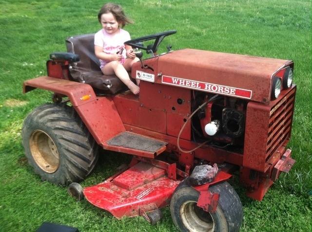

newtowheel 6 #1 Posted April 30, 2016 I have a onan twin cylinder D 160 1976 I believe it to be, I bought it recently unfortunately they left out the part of it missing a piston. Does anyone have any suggestions where to find a crank and piston or complete rebuild kit for this engine? I will post model and serial number later. Thanks for any and all input. 1 Share this post Link to post Share on other sites
SylvanLakeWH 32,934 #2 Posted April 30, 2016 Some wiser folks will pipe up shortly with direction for you on the engine. Those big "D's" are cool! In the meantime - - and from the looks of her face in the picture you better get a move on... she wants a ride sooner rather than later!!! 2 Share this post Link to post Share on other sites

newtowheel 6 #7 Posted May 2, 2016 On April 30, 2016 at 0:29 PM, SylvanLakeWH said: Some wiser folks will pipe up shortly with direction for you on the engine. Those big "D's" are cool! In the meantime - - and from the looks of her face in the picture you better get a move on... she wants a ride sooner rather than later!!! Yeah I know lol she loves taking rides. Share this post Link to post Share on other sites
