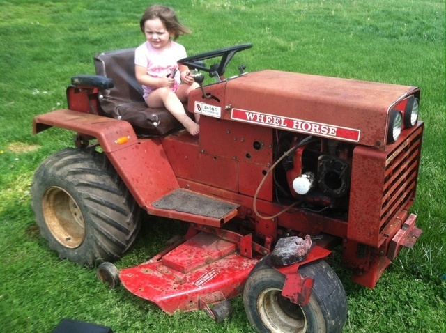

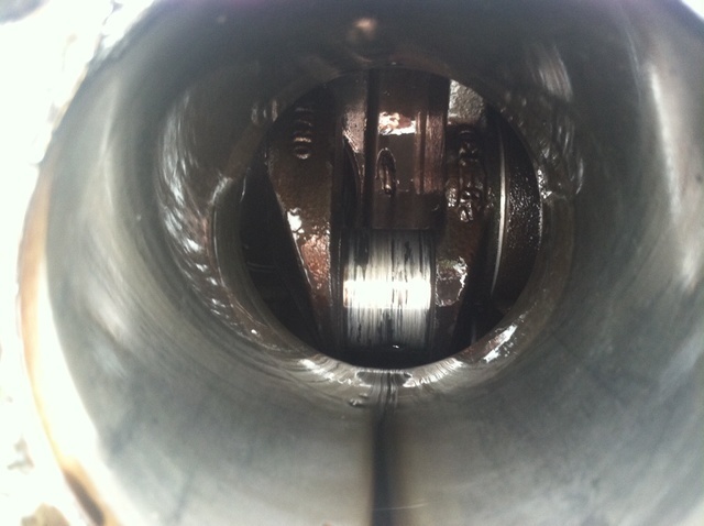

newtowheel 6 #9 Posted April 29, 2016 Ok I did what lynnmor suggested did a compression test great news on one cylinder I have 100 pounds the bad news I found the issue. Apparently I bought a lame horse or someone snuck in at night and borrowed one of my pistons.hopefully they will return it soon. I attached a pic of the horse and my assistant mechanic. Also posting the issue. Where would be a good place to locate a crank and piston? Also thank you to everyone who commented I will be attempting a restoration on the horse since I will have to break it down anyways. 2 Share this post Link to post Share on other sites
r356c 375 #10 Posted April 29, 2016 There are no eyes bugged out, jaw dropped images or I would put one here. It would be nice if a seller would mention that a piece of equipment had thrown a rod... I have no doubt that she will enjoy riding around on dads Wheel Horse one day. 1 Share this post Link to post Share on other sites

newtowheel 6 #14 Posted April 30, 2016 (edited) I sent them a message along with a picture of the run away piston boomer I will let you know what the response is in return. I got a reply in return their son was mowing with it a few days before you bought it..... I'm probably going to get nowhere with this one. i got Edited April 30, 2016 by newtowheel Share this post Link to post Share on other sites
Blue Delta 35 #15 Posted April 30, 2016 There is no way that was mowing a few days before there would not be any power and removing it would require pulling the engine apart. 2 Share this post Link to post Share on other sites
