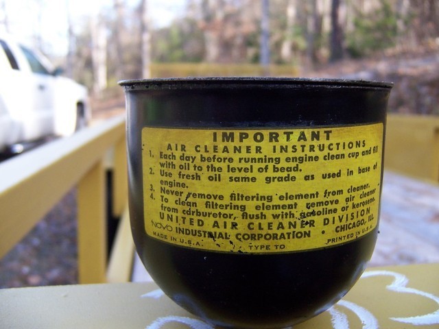

Indiana_Steve 125 #3 Posted April 29, 2016 I can't seem to find a complete oil bath(parts) or I would leave it alone. Thanks. Share this post Link to post Share on other sites
953 nut 67,523 #4 Posted April 30, 2016 The same oil bath air cleaner was used on Cub Cadets and lots of others. The NOVO corporation made them, broaden your search criteria and you may have better luck. 1 Share this post Link to post Share on other sites
