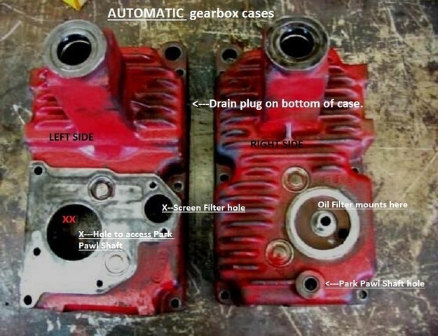

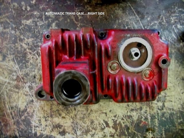

daveoman1966 3,884 #4 Posted April 28, 2016 (edited) Here is the Auto trans gearbox. This is from a C series..... C-160 . It is cast iron and in great considition. You could swap this onto your tractror. For further details...send me an off-site email. My direct email is: daveoman@windstream.net Edited April 28, 2016 by daveoman1966 3 Share this post Link to post Share on other sites

daveoman1966 3,884 #8 Posted April 29, 2016 The RIGHT SIDE trans case is part # 103636. Here is the trans axle schematics for 71-16KS02... and other schematics as well. As noted earlier, I have this part in my shop. https://www.toro.com/en/parts/partdetails/?id=5253 Share this post Link to post Share on other sites
