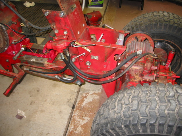

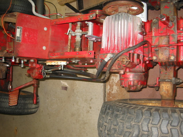

pfrederi 21,274 #2 Posted April 27, 2016 (edited) The front port on the lift cylinder should go to the rearmost port on the control valve The rear port on the lift cylinder goes to the front most port on the valve The outer (left side) port on the control valve goes to the rear of the hydro pump The inner (right side) port on the valve goes to the port on top of the hydro pump I based this on one of my Sundstrand units, Edited April 27, 2016 by pfrederi 2 Share this post Link to post Share on other sites
