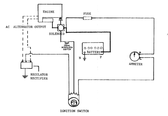

howell1000 35 #1 Posted April 27, 2016 I HAVE 486 WITH KOHLER 16 HORSE JUST PUT ON NEW STARTER NEW BATTERY NOW IT TRIPS FUSE AND WHEN I DO GET IT TO WORK IT WILL NOT MAKE THE STARTER BENDIX ENGAGE THE ENGINE PLEASE HELP Share this post Link to post Share on other sites

rmaynard 17,644 #3 Posted April 27, 2016 (edited) The only fuse in the circuit should be on the ammeter side of the solenoid. (see image) If the starter is mounted slightly crooked, the Bendix will not engage and the teeth on the starter will not line up with the teeth on the flywheel. Check your mounting alignment. As far as the fuse blowing is concerned, when the ignition switch it engaged, the power goes to the coil side of the solenoid. If the solenoid is bad, it could potentially blow the fuse. Edited April 27, 2016 by rmaynard Share this post Link to post Share on other sites
