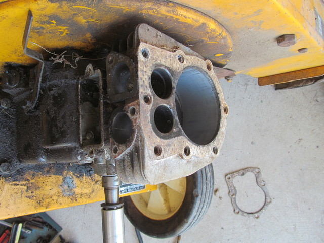

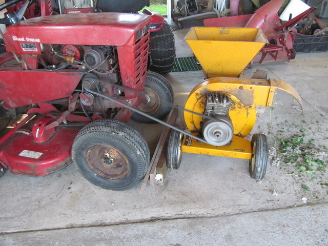

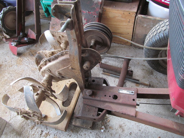

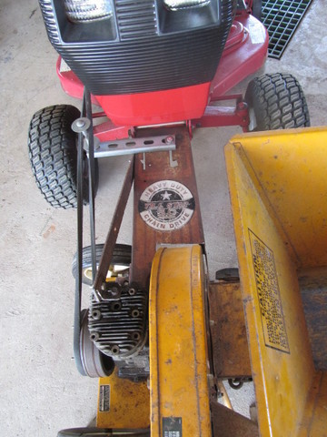

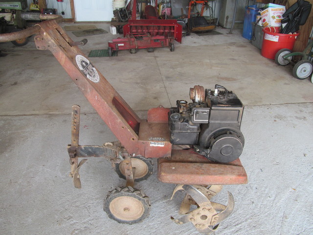

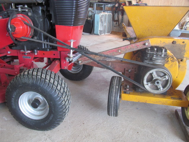

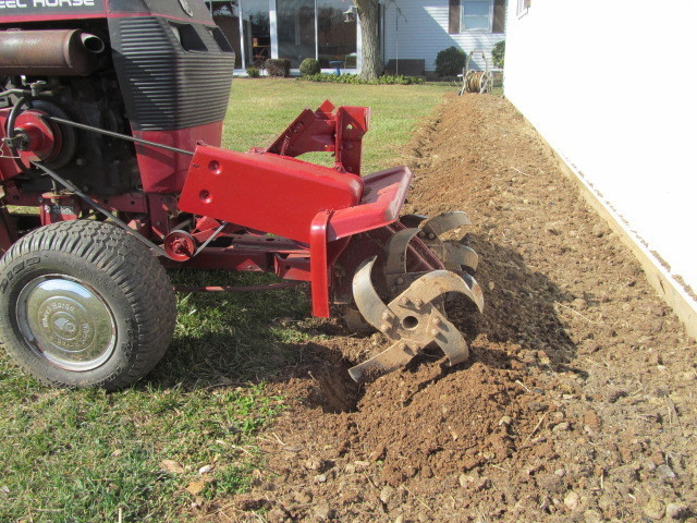

Ed Kennell 46,608 #1 Posted April 26, 2016 This was a project I started over a year ago, but I never finished making a mount to the attach-a-matic. Looking thru the "junke" pile, The handle frame that was left from the MAD MAX tiller looked like a chipper mount. I had removed everything from the blown engine except the crankshaft and used it as a bearing block. I bolted a V pulley to the flywheel and removed the aluminum shear key and made a hardened steel key to strengthen the drive train. I seemed to work OK when I blocked it to the 875. This is the old tiller I converted to Mad Max. MAD MAX And now the Mad Chipper. 13 Share this post Link to post Share on other sites
JAinVA 4,638 #2 Posted April 27, 2016 (edited) .Ed, Haven't seen a belt arrangement like that except for long flat leather belts.How long do you think that the drive belt will last? I have thought about having a tractor mounted chipper but the engine turns the wrong way for most.Never thought about what you have discovered.Love the out of the box thinking! Thanks,JAinVA JimAnderson Gloucester.Va Edited April 27, 2016 by JAinVA 2 Share this post Link to post Share on other sites

Ed Kennell 46,608 #6 Posted April 27, 2016 1 hour ago, JAinVA said Quote .How long do you think that the drive belt will last? Only time will tell. I don't think the twisting will have much affect on the belt life. My concern was the rubbing and the resulting heat at the crossover. So that is why I added the separator. That is a piece of SST tubing spinning on a greased bolt. There is not much side load on the tubing as the belt puts the same force on both sides and both sides spin the tubing in the same direction. I did consider an idler pulley on the return side of the belt to keep them separated. If this one fails we'll go to plan B. Quote 5 Share this post Link to post Share on other sites

Docwheelhorse 2,991 #10 Posted April 27, 2016 Like the idea, love the front tiller.... but I'm wondering what's going to lube the Crank bearings on either end of the block on the chipper. How about putting the piston and rod with the dipper back in and leaving the plug out / blocking the intake, exhaust ports.... fill 'er up with oil and off to the races... Tony Share this post Link to post Share on other sites
Ed Kennell 46,608 #11 Posted April 27, 2016 Thanks Tony. The block is filled with oil high enough for the crank to dip in at the bottom of the stroke. This should throw as much or more oil on the bearings as the piston rod dipper. The valves and piston have been removed, so they don't need any lube. Yep, T & E is trial and error in my vocab Jim........ I can't wait to hear your definition though. 2 Share this post Link to post Share on other sites

squonk 47,421 #15 Posted April 28, 2016 I put a horizontal snowblower on a vertical shaft tractor and twisted the belt. A regular belt lasted an hour, but a green Napa Belt would last 4 seasons. It would wear down and eventually flip over but kept up driving with no slipping. 2 Share this post Link to post Share on other sites
