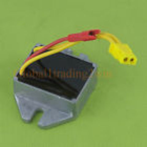

WHX?? 55,727 #4 Posted April 26, 2016 Has it got a voltage regulator like this? More than likely what it is they go out all the time. Replacements are cheap ( maybe that's why they go out often) and can be had everywhere. Wouldn't hurt to check the charge coils tho. Share this post Link to post Share on other sites

gwest_ca-(File Mod) 12,072 #8 Posted April 27, 2016 7 hours ago, car said: The voltage was the same at the regulator. So do you think I should replace the regulator? No not yet. I should have asked what the voltage reading was on the first test. If it was 12 volts or more move on. To rule out a problem with the ignition switch do that same battery voltage check at the battery and the regulator with the engine running at a fair speed this time. If the readings are the same move on. Remove the connector from the voltage regulator. Switch your tester to AC volts and place the test leads on the other two wires in the regulator connector. At full engine rpm you should have at least 28 AC volts. If you do get that then the regulator is most likely at fault and requires replacement. If you don't get 28 AC volts there is more stator testing to do and the regulator is not likely at fault. Garry Share this post Link to post Share on other sites
