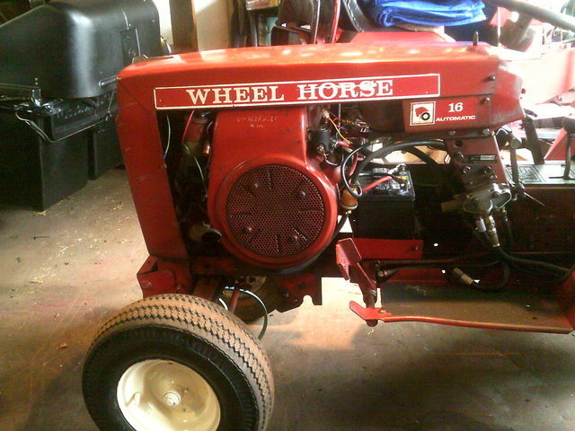

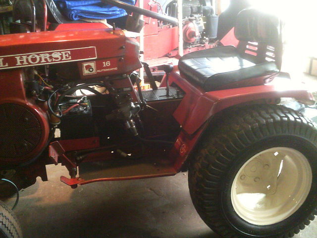

illinilefttackle 399 #1 Posted April 26, 2016 Hello Guys- I'm finishing a 1973 16 AUTO Tractor- The last thing I need to do before it's finished is change the Trans Fluid ( Dextron lll) & Filter- I want to be positively correct on the Filter it takes- NAPA can only tell me -1410 Or 1307- NAPA filter. Can anyone tell the the correct one- or should I just try to Deal with Toro? Thanks- Al Sundstrand trans Share this post Link to post Share on other sites
