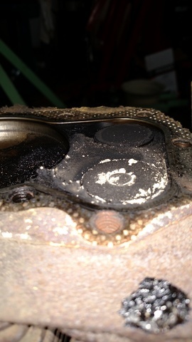

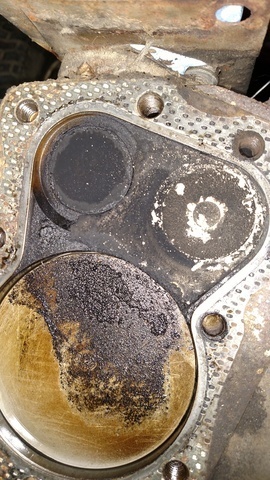

welderman85 53 #4 Posted April 26, 2016 (edited) Sooty and had white deposit s on it So after pulling the plug I decided to dig deeper so i pulled the head off and this is it. Whats the best way to clean this up and whats my next move from here. Thank you Also where's a good place to get a head gasket and carb rebuild kit. The bottom pic dosnt show it to well but the carbon is around 1/4 to 3/8 high around the edges Edited April 26, 2016 by welderman85 Share this post Link to post Share on other sites

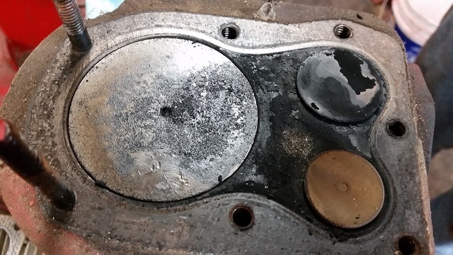

prondzy 3,889 #6 Posted April 29, 2016 Your burning oil, and most likely have lower compression. My suggestion is to rebuild and machine the cylinder. See the "clean" c shaped ring on top of the piston, this is where oil has sat and why there is no carbon buildup like you have elsewhere. And why it is built up 1/4 to 3/8 in other spots because of excessive blow by. Of course not many people want to spend the $200-$300 to rebuild you could try, cleaning the carbon out if the head and cylinder, a new headgasket, sparkplug, run a cap full of sea foam through a full tank of gas, and a cap full in the crankcase and hope you just have a stuck ring, but I'll put my money on needing a rebuild. This is what a healthier engine should look like when you pull the head, this one of course got a rebuild for the same reasons you are describing. Share this post Link to post Share on other sites
