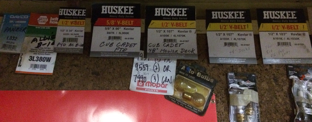

Tankman 3,528 #5 Posted April 26, 2016 (edited) Ron 4L or 5L, wouldn't know. I just get the 5/8" x 82" Huskee Kevlar V-Belt. 1/2" belts, same. I do have other equipment with size specific belts but not the Horses. Belt packaging sleeves I label and staple gun to my shop wall; i.e.: 48" decks, 520-8 drive, etc. Edited April 26, 2016 by Tankman Share this post Link to post Share on other sites

doc724 927 #7 Posted April 26, 2016 2 hours ago, Tankman said: Belt packaging sleeves I label and staple gun to my shop wall; i.e.: 48" decks, 520-8 drive, etc. I love it. I do the same thing. I even hang up used belts just in case of a catastrophic failure and tag them with manila tags. 1 Share this post Link to post Share on other sites
tunahead72 2,633 #8 Posted April 27, 2016 54 minutes ago, doc724 said: ... I even hang up used belts just in case of a catastrophic failure and tag them with manila tags. Yep, likewise. 1 Share this post Link to post Share on other sites
Tankman 3,528 #9 Posted April 27, 2016 (edited) If the belt is not broken or chunked, labelled and hanging on a 16p nail, always labelled. Picture, a small view of one of my shop rafters. My memory ain't so good or, I could go through the files, or turn on the computer. Easier just to look towards the Heavens. Edited April 27, 2016 by Tankman 1 Share this post Link to post Share on other sites
